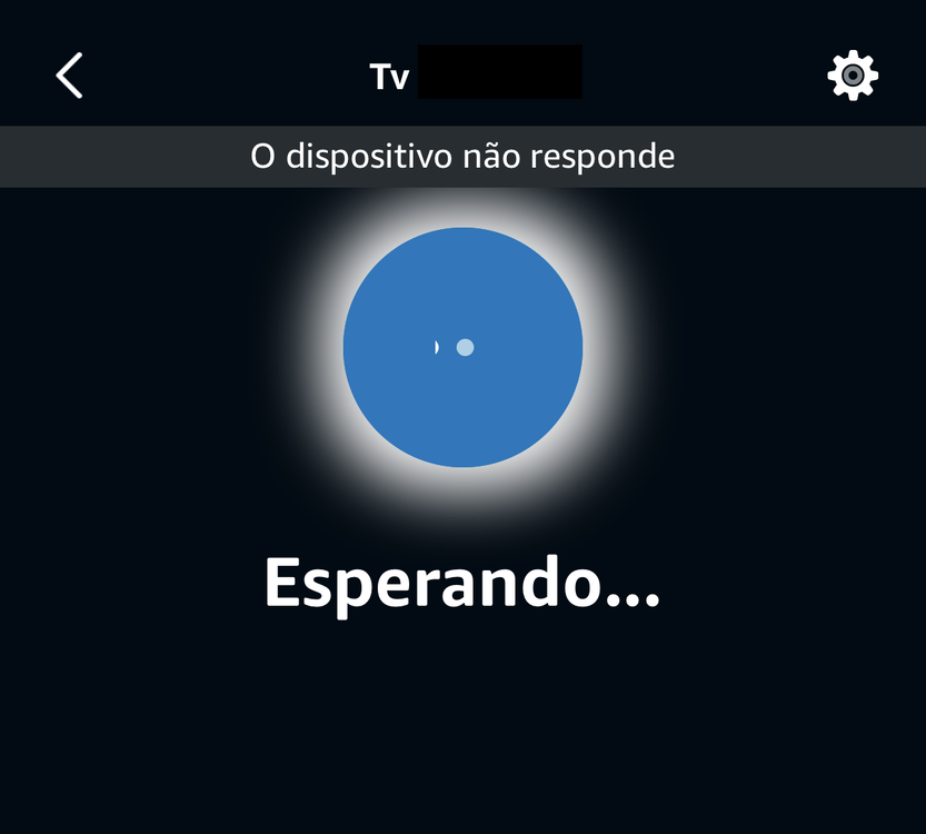

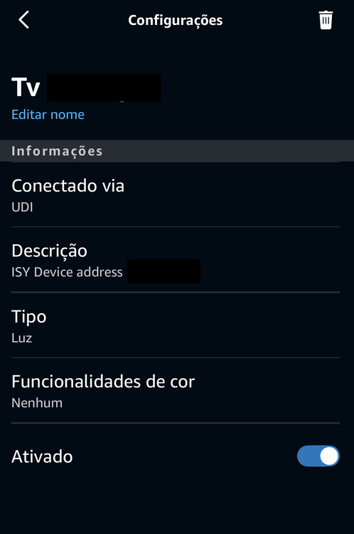

September 28Sep 28 It used to be 100% stable but now I'm still facing issues with Alexa commands to turn on/off from time to time. It answers "ok" but the lights/outlets do not respond. How can I troubleshoot it?

October 9Oct 9 @MFBra or @zorax2 Please give more details so others might be able to help. But there have been reports of the new Alexa+ is having issues with home automations or skills in general (Other posts on the forums have mentioned issues). Please post more about your situation: UD Device in use? Firmware number (specific number not just "current"/"latest")? What kind of devices are not responding (Insteon or other tech)? Are you controlling an actual device, program, or scene? Always best to include more information rather than just saying, "something isn't working 100% of the time". It's kind of hard to troubleshoot...that's probably why there were no replies to initial post a couple of weeks ago. On 9/28/2025 at 12:19 PM, MFBra said: How can I troubleshoot it? Simple troubleshooting: Power cycle Alexa device(s) Powercycle UD Device Control device with other method (UD Mobile, Admin Console, Physical switch) Confirm UD Portal license is current Confirm UD Portal is using proper device (UUID) and linked to Alexa Look at "My Profile" and see that preferred UUID is correct Click on Connectivity and confirm UUID is active UD device Confirm Alexa Skill is linked to UD Portal account - might need to unlink/disable skill and then re-enable to re-link
October 11Oct 11 Author On 10/9/2025 at 12:15 PM, Geddy said: @MFBra or @zorax2 Please give more details so others might be able to help. But there have been reports of the new Alexa+ is having issues with home automations or skills in general (Other posts on the forums have mentioned issues). Please post more about your situation: UD Device in use? Firmware number (specific number not just "current"/"latest")? What kind of devices are not responding (Insteon or other tech)? Are you controlling an actual device, program, or scene? Always best to include more information rather than just saying, "something isn't working 100% of the time". It's kind of hard to troubleshoot...that's probably why there were no replies to initial post a couple of weeks ago. Simple troubleshooting: Power cycle Alexa device(s) Powercycle UD Device Control device with other method (UD Mobile, Admin Console, Physical switch) Confirm UD Portal license is current Confirm UD Portal is using proper device (UUID) and linked to Alexa Look at "My Profile" and see that preferred UUID is correct Click on Connectivity and confirm UUID is active UD device Confirm Alexa Skill is linked to UD Portal account - might need to unlink/disable skill and then re-enable to re-link Thanks for the help : Eisy Version : IOX v.5.9.1 (2025-03-05-10:18:08) IoX v.5.9.1 (2025-03-14-16:21:41) eisy (5226) OpenADR (21010) Networking Module (21040) Portal Integragion - UDI (21075) Z-Wave Module (21100) A10/X10 Module (21060) Portal Integration shows Registered Internet Access disabled Power cycle Alexa device(s) - Did Several times Powercycle UD Device - Did at least twice Control device with other method (UD Mobile, Admin Console, Physical switch) - Yes, even with Alexa it sometimes works, its "erratic" Confirm UD Portal license is current - Portal Integration shows Registered Confirm UD Portal is using proper device (UUID) and linked to Alexa - Yes, just have one eisy registered Look at "My Profile" and see that preferred UUID is correct - Correct Click on Connectivity and confirm UUID is active UD device - Correct Confirm Alexa Skill is linked to UD Portal account - might need to unlink/disable skill and then re-enable to re-link : its is connected. The issues I'm facing : - Alexa says "ok" to a command but it never happens - Alexa says "ok" to a command but it takes 5-10 seconds to execute - Alexa says "ok" to a command and it works "almost immediately" Devices failing are majority Insteon : - (2443-222) Micro Module On/Off v.48 - (2876SB) Icon Relay Switch v.39 - (2477D) Dual Band SwitchLinc Dimmer v.45 - (2856S3B) Icon Relay 3-Pin v.39 - Sonoff Devices, firmware tasmota, thru MQTT If a command fails, repeating it usually works flawlessly, but sometimes it doesn’t, there is no distinction of which Alexa devices I'm talking to, I have 4 (3 distinct models : 1 3rd Gen, 1 Dot and 2 Spots) Thanks in advance!
