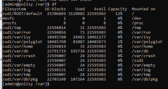

October 2, 2025Oct 2 Log in with ssh and do the "df" command to show the disk apace, and post a picture of the screen.
October 2, 2025Oct 2 Author I doubt this has anything to do with the "small image size" issue. I really don't understand why I was asked to upgrade to 6.0 when I connected via the launcher. I haven't read anything about that anywhere. And why doesn't it do that with my main Polisy? The release notes suggest that the upgrade requires manually clicking "upgrade packages" in the AC. -Tom
October 2, 2025Oct 2 That looks good, so it's not a messed up filesystem. 1 minute ago, xlurkr said: I doubt this has anything to do with the "small image size" issue. I really don't understand why I was asked to upgrade to 6.0 when I connected via the launcher. I haven't read anything about that anywhere. And why doesn't it do that with my main Polisy? The release notes suggest that the upgrade requires manually clicking "upgrade packages" in the AC. -Tom Normally when the upgrade finishes, it prompts you to reboot. See that at all?

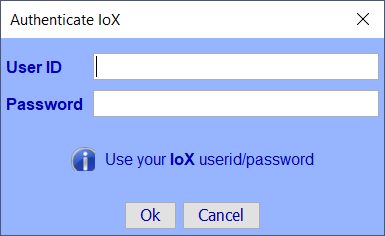

October 3, 2025Oct 3 I notice that when you log into with the launcher, the login box actually tells you what login to use. On both of my test units (both Polisy) the box has the User ID and Password fields, and underneath it tells me "Use your IoX userid/password". I imagine that for those who now log in with their portal credentials, it must tell you to use those instead? Because not everyone has portal subscriptions.
October 3, 2025Oct 3 Author The one I was upgrading had a lapsed portal subscription, but I hope that didn't have anything to do with the failure. btw, Michel got back to me and told me to flash it. I have the USB device from back when they all had to be flashed if they had the old FreeBSD version, but I'd rather try anything else first. Anyone have any suggestions? -Tom
October 3, 2025Oct 3 No, if Michel tells you it needs flashing, then that's your next step. That's a more extreme solution because you're not recovering anything, so if you have no backups, this really sets you back. About the portal subscription or not and my login screen comment above: I might have a bit of an exception here. I have two Polisy units, that I use for testing and learning. Polisy 1 has a few test nodes defined on it, and a lapsed portal subscription. Polisy 2 is one that I got recently, given to me for free by a generous forum member. He said it was messed up, it wouldn't even boot up. I ended up getting an image file from UDI and buying the needed USB adapter card to enable flashing the SSD using Rufus. That worked...I think. As I posted in another thread, it was seemingly working fine, and I picked that one to try the 6.0.0 upgrade. Well the upgrade failed (it stayed at 5.9.1) and when I started checking it out, I had the same issue as @apostolakisl: a 3 GB filesystem and the upgrade was failing due to disk being full. I haven't proven it but my thinking was that maybe I made a mistake when using Rufus to flash it's SSD. Well ok, so then I tried the upgrade on Polisy 1. That worked great. So I had an idea: make an image file of the SSD of Polisy 1 using Rufus, then I used that image file to reflash Polisy 2. So now I had a clone of Polisy 1 running fine on Polisy 2. Already upgraded to 6.0.0 too. Now back to the portal subscription thing: Polisy 2 was eligible for the free 1 year portal trial subscription (the previous owner had never subscribed), which I enabled. Works fine. Portal access is up and running on it. But, it was running an image of Polisy 1, which had a lapsed portal subscription. The 6.0.0 upgrade process was done on that unit, then the image copied over to Polisy 2. So the 6.0.0 upgrade process must check if you have an active portal subscription, and configure the Admin console login to use the usual IoX login and password if you have no portal subscription, or use your portal credentials if you do. Since the upgrade had been done on a no subscription unit and then copied over, Polisy 2 is having me log in using the IoX login and password, but still has a working portal subscription. I'm sure there must be a simple configuration file somewhere that tells the admin console login program which user name and password (IoX or portal) to use, and that could be easily changed to use one or the other.
