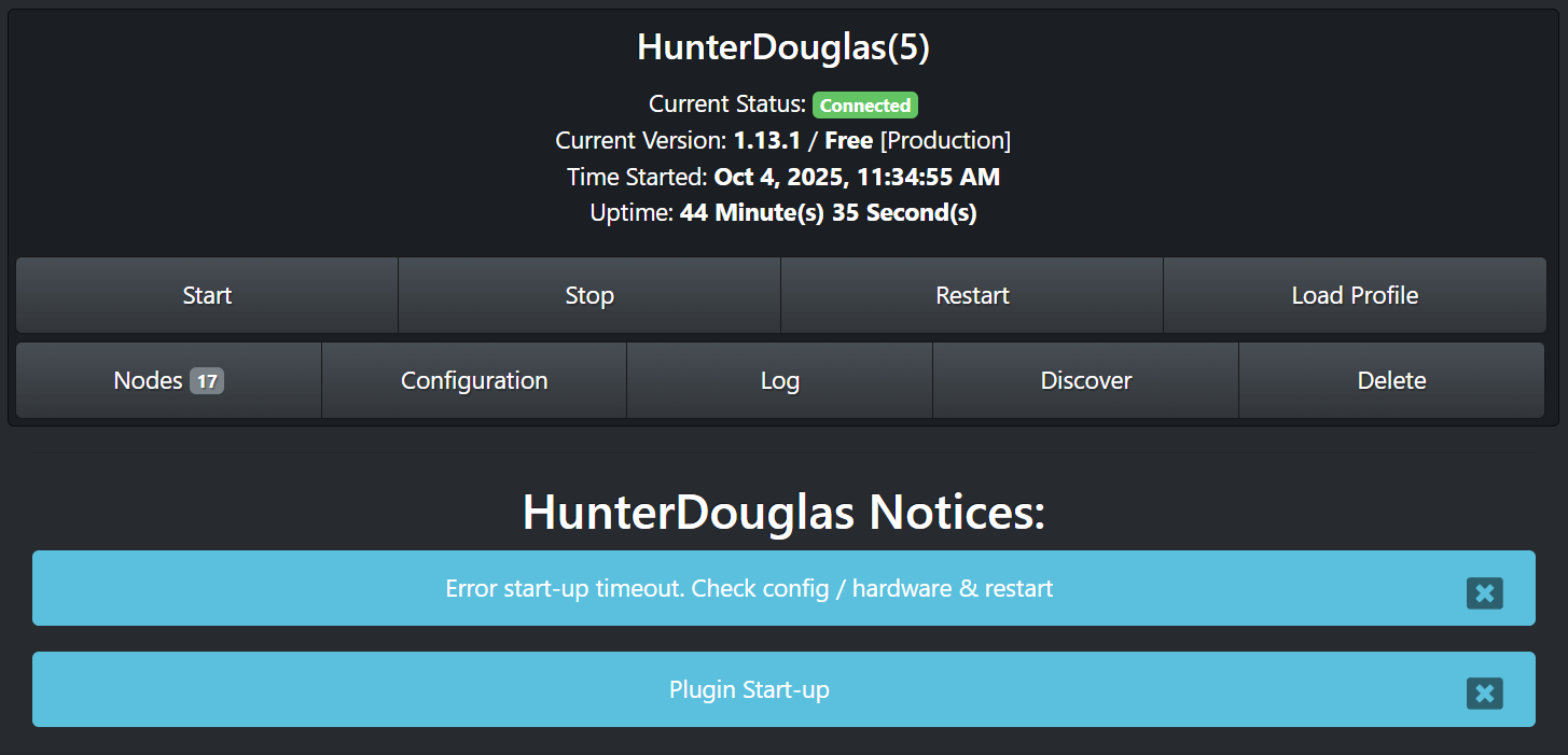

9 hours ago, GTench said:
@sjenkinsSeems to be running according to the AC but PG3 shows this message
Can you restart and send me logs please.
@GTench, can you go to the log tab in the plugin then hit the download log package a minute or two after a restart.  Gives me more than the system log.  Thanks.
The logs look quite clean & without error except for a timeout in start-up gathering parameters, but they are ok too.
It looks like the startup is taking longer on your machine than the timeout allows, which is why the messages.
I think you are on a Polisy, correct?  That may be why its a it slower.
I have raised it & pushed to production.
Please re-install the production version in the same slot as your current & let me know how it goes.
thanks again for your patience....
@sjenkinsthanks again for looking into this. The reinstall worked without raising the error message. I am running on eisy and have been since it was introduced
Good news!  Interesting that they are starting up at such a different speed.  I learned something on this one.  The timer should be significant anyway, well out on the normal curve, as its just to flag if something isn't right.
