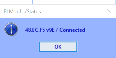

  • In iox. Go to tools / diagnostics / PLM info. What does it say?
  • Report that back

paulbates, I am attaching a snip of the information for my serial PLM.
