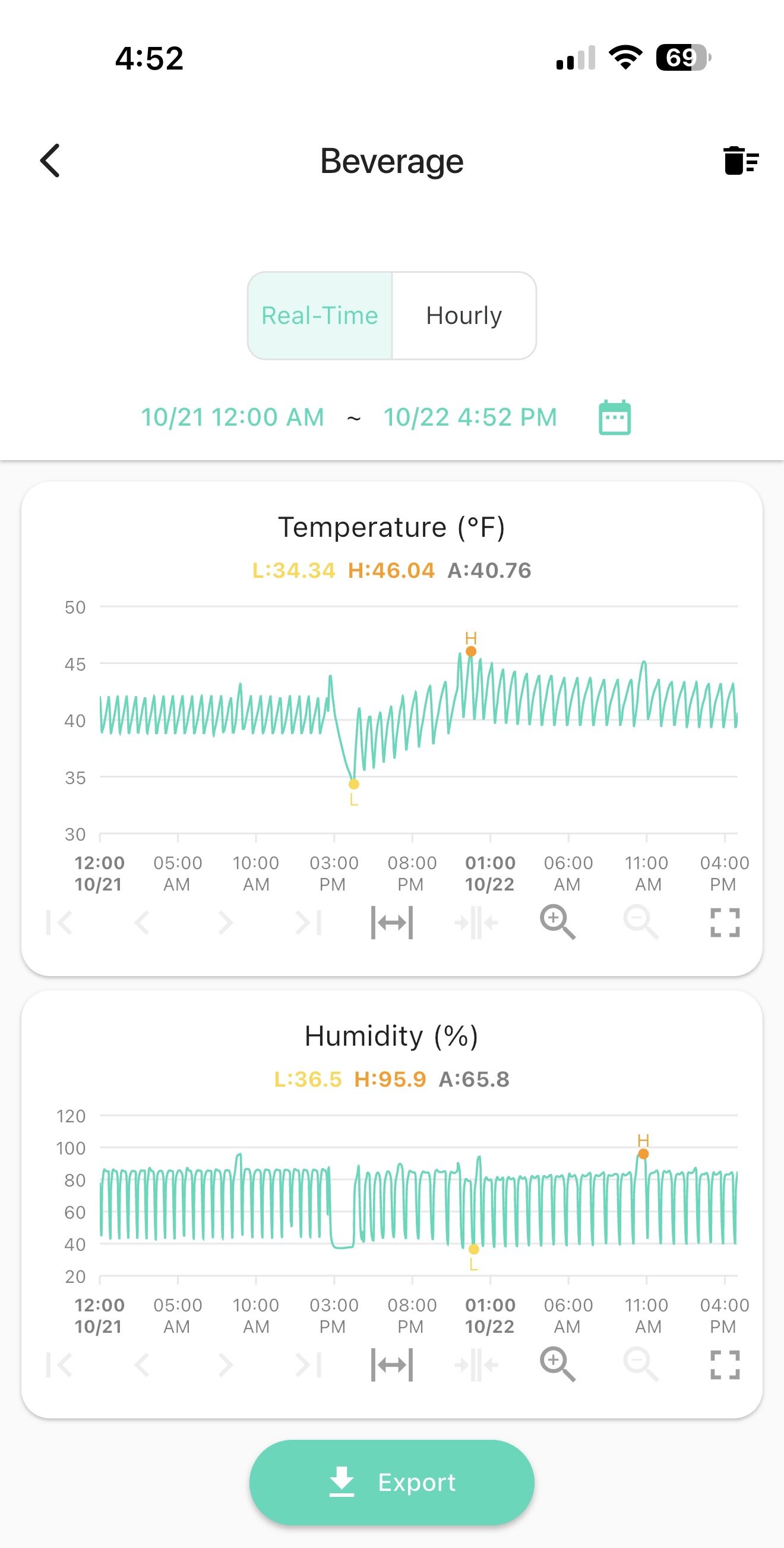

I also really like the wireless tag graphing they do on their app and website. Does Yo-link have all the features for zooming in/out changing scale and whatnot like wireless tag?
Yes, it graphs well. It will do current day or historical. And you can zoom in/out as you wish. You can move along the line to see the time of the temp change.

@apostolakisl YoLink will not do every 30 seconds and can't be plugged in. So, I agree you should stick with your tags if that is important to you. They only update when the temperature changes by a set degree - that's how the battery life is prolonged. I find the sensors without a display last longer than the ones with a display. Good luck with your authorization issues.

Can you set the temp interval or is it predefined? I could make this work just fine if I could set it to something like .5 degrees F.
