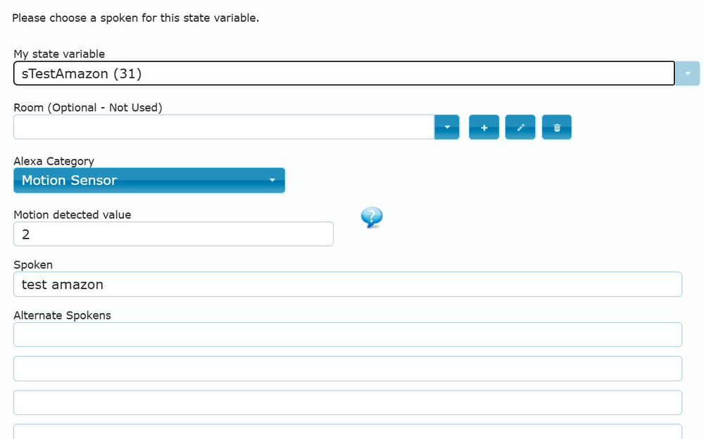

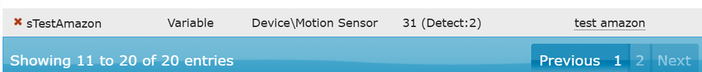

December 28, 2025Dec 28 1 hour ago, tazman said:Then it definitely seems to be a problem between the portal and Amazon servers. If you have other devices working then maybe post a screen shot of your portal setup of the variable. Are you using a state variable? I never used an integer and don't know if they work.Alexa and ISY are communicating fine for all of my voice commands to Alexa. I can't imagine that my configuration in the portal is wrong. Not a whole lot to do wrong. I chose "2" as the detected value, but I also tried 1.
December 28, 2025Dec 28 @apostolakisl I can imagine your frustration. I have motion sensors, scene and light as shown below. They all work as expected.JHHave you tried to to delete the variable and start over completely? Be sure you are also deleting in Alexa any old devices/variables when you do that. This may also be causing Alexa some confusion.
