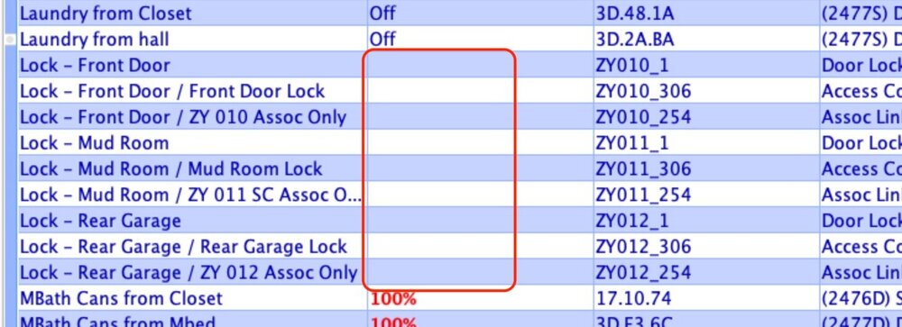

Clarification of this ongoing problem with UDI's portal connections affecting ELK and ZWave status not being reported unless query is run.
This has been documented since the end of October in this thread and is as yet unresolved.
UDM Local WiFi connection:
-Working as expected; Elk reports names for status ie: armed away vs a number ie 1
AC Direct Connection: No issues, works as expected.
UDM REMOTE connection:

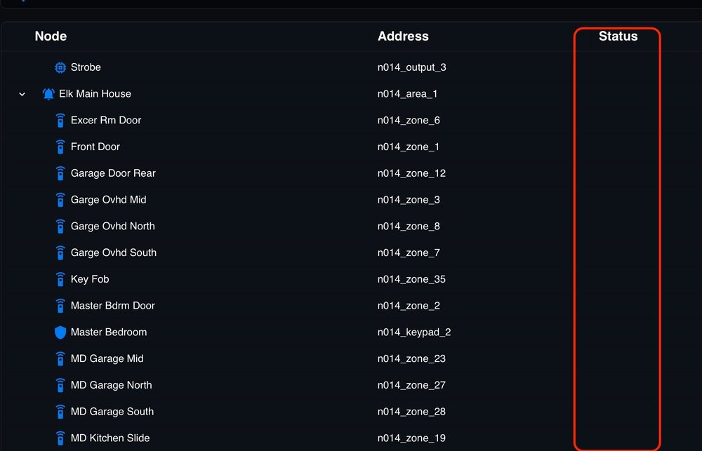

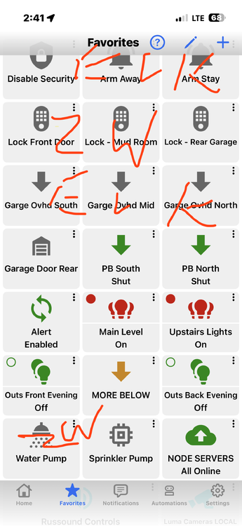

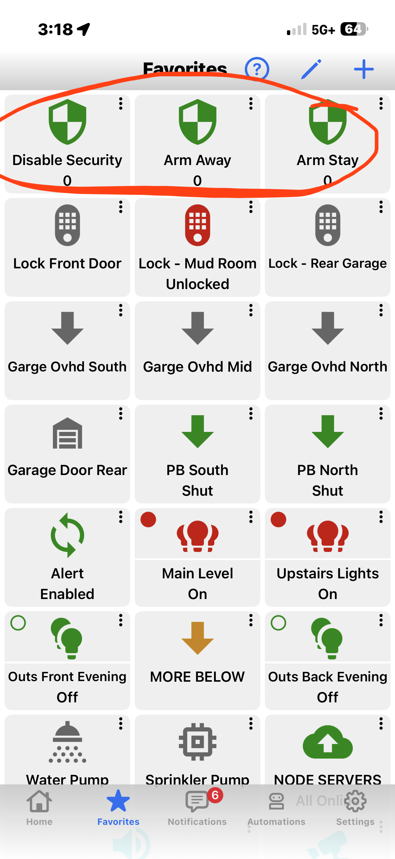

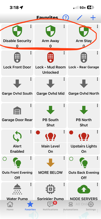

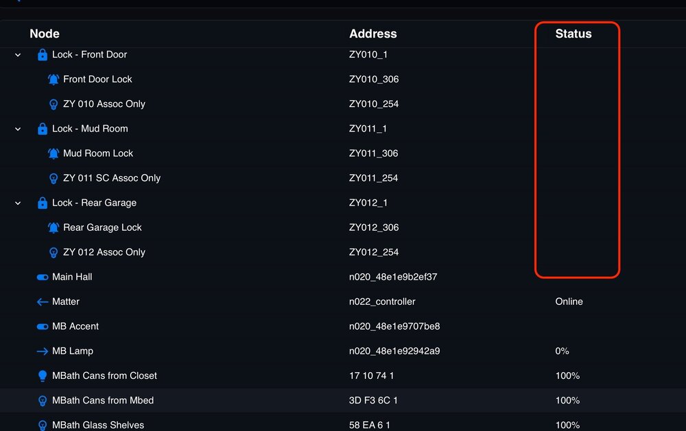

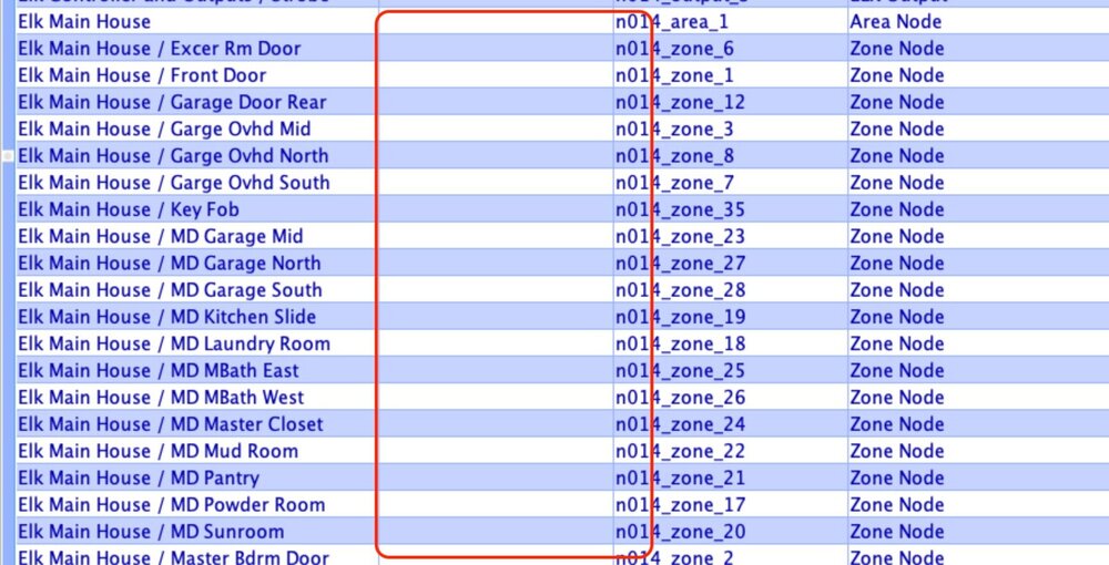

-When NOT on local wifi, UDM does NOT report Z-wave or Elk status in favorites or EIsy devices, unless the dashboard for the device is opened. See screen shot below of my top favorites page. Some items are ELK and others are z-Wave.. all greyed out unless I open the dashboard of each device, with ELK only reporting numbers, no status.
New UI:
-same issue with elk and zwave not populating status. See screenshots below.
AC Through http://my.isy.io...:

I tested UDM on remote connection.
1) opened app. Elk nodes all blank.
2) I opened a door and the elk node immediately reflected its status in words as expected
3) I shut the door. and again it reflected the status correctly
4). changed pages on UDM app and went back to page with the above door and status remained correctly filled
5) Quit the app and reopened it. Blank status again.
Edited by dbwarner5
@Javi I upgraded to EisyUI0.8.5.
UDM acted very strange. Had to do several restores and Syncs to get it to work properly, even locally. That is now ok.
UDM remote though is reporting elk properly, but no Z-wave and now various Insteons no longer report status as well.
Opened AC thru my.iso and it is the same as UDM remote: no zwave status and various Insteons no longer reporting status.
