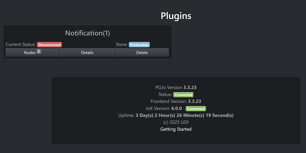

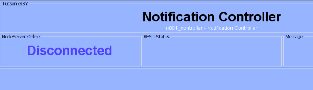

I have two eisy's each in a different location. I upgraded one eisy a couple weeks back and had no issues whatsoever. In the last few days, I upgraded the other eisy when I got to it and all seemed good. However I noticed today that I was not receiving any UDMobile notifications via the notifications plug in. When I checked the plugin it stated it was disconnected. PG3x was running fine, just that notification was disconnected.
I tried stopping and restarting the plugin. I rebooted the eisy. Nothing brought it back online. A weird thing is when I stopped the notifications plugin, the timer kept counting being online... not the PG3x but the notification plugin. When I started it again, the counter never zeroed out to start again the time online or connected.
How do I reconnect after this upgrade so notifications is connected and works again after this major upgrade?

While I didn't experience problems with this plugin when upgrading to IoX 6.0, I did experience the same problem with the Elk plugin with 2 different systems.
In both cases, the fix was reinstalling the plugin in the same slot. Worth noting, it did take several reinstalls before everything worked like it should.
@DennisC THANK-YOU!!!! It took two reinstalls and that did the trick. Reconnected!! It always stated that thigns were running, just not connected. I was panicked as I get a bunch of notifications via the UDM!!
