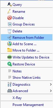

There used to be an option to replace a defective device easily in the UI but that option seems to have disappeared over time. What's the easiest way to remove/replace an existing Insteon device in all programs, scenes, etc?

First you have to remove the device from the folder, then you'll see the Replace with option.

You don't want to delete the old device, just move it from the folder to the main tree. Once it's in the main tree you should install the new device, then in the old device click on replace with and point to the new device.
The controller will reboot and the old device will be gone.
