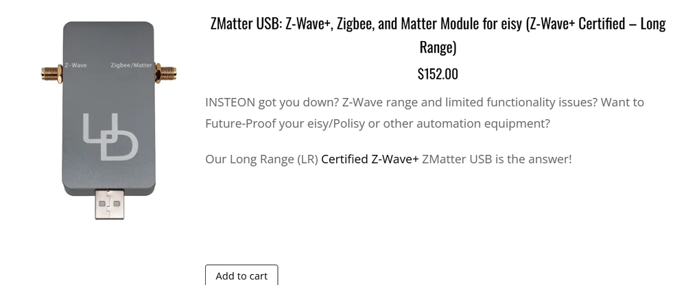

Thanks......I was referring to the below, which implies it supports LR....or is it that the currrent dongle doesnt yet support LR, but will....any insights ?

Hi all...in case it helps anyone, Michael was able to get back to me directly. The dongle is 700 based, not 800, so yes it's 'long range' but it's not 800 long range. Yes, that's a little confusing.
