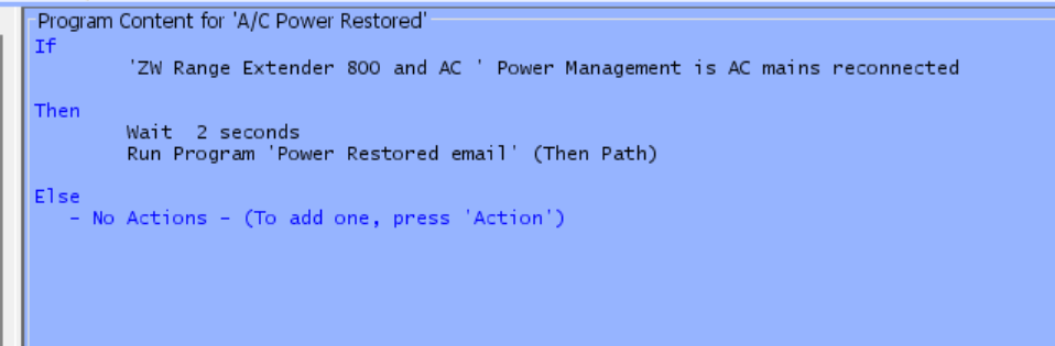

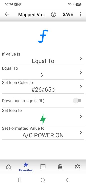

Attached are two screenshots. The EISY shows "AC MAINS RECONNECTED"
UDM is only offering a numeric value
This is a Zwave device.
UPDATE: The numerical values corresponds to the correct Text. By selecting a value of "3" the correct text value "AC MAINS CONNECTED" displays
Edited by Techman
