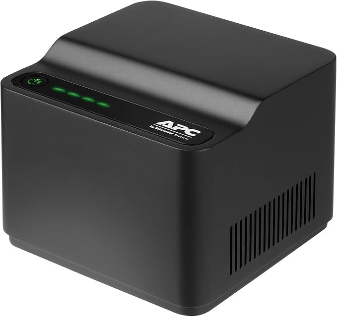

I know I could just get a normal UPS and plug the UD 12v power supply into it, but I have always preferred a direct DC UPS. The Polisy ran on a APC UPS Back-UPS Connect CP12142LI :
The advantage to this is the device is further separated from the power line, there is no transfer time, and most importantly, without inverting DC battery energy to 120V 60hz AC only to convert it back to DC I realize vastly longer run times for the same size back up battery. Actually, the DC UPSs usually end up being less than half the size of a normal standby UPS.

Well, ideally for me would be if I could continue to use my APC DC backup. It outputs a regulated 12V up to 3.5 amps on a standard DC barrel connector. This plugged directly into the Polisy. It should be able to power the eisy for like 12 hours or more. So do you think a simple adapter like:

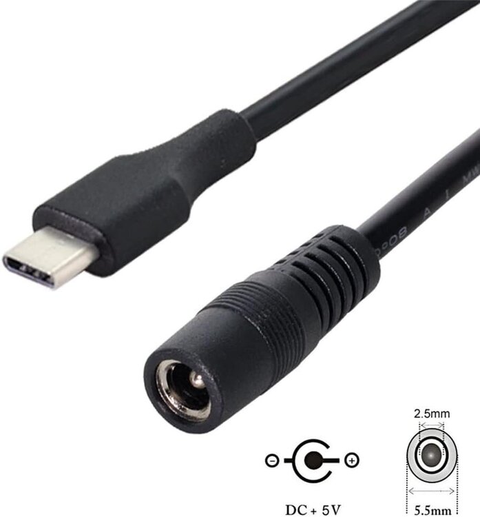

This is really a great link too. Thanks Brian. Based on this I am first going to try an adapter cable going from barrel to USB C. I am also going to buy a USB C meter/tester and play with that before connecting to my eisy.

Okay, my solution is in place and seems to be working flawlessly. All I did in the end was buy an adapter cable, pictured below, and connect that to my APC DC UPS barrel connector. This USB C connector is then connected to the power input port on the eisy, not the full function port. I did buy a USB C meter with PD triggering and did lots of testing before connecting my new eisy R2 to the power. It seems to me that the warning about using any other power supply with the eisy R2 is a bit backward. It is the included power supply that should never be connected to anything else. It spits out 12V all the time and ignores all PD protocols. It will have a good chance to wreck anything else you plug it into. But this version of eisy does seem like it could take a PD compliant power supply through either USB C port, but I am not going to be the one to mess with that as my solution works for application very well. Thank you all for your advice and direction.

Unless they cheaped out, the power supply should be PD3.0 meaning that it doesn't deliver power until after it first does a data link to the device and establish what voltage is requested. Maybe I'm wrong, but that is how I understand it. Perhaps it might deliver 5v if there is no PD3.0 data connection established. A USB C power supply that just spits out 12v no questions asked would be a dangerous thing.
And obviously your USB C to barrel connector could also be a dangerous thing depending on what voltage you plug into the barrel and what USB C device you plug it into.
