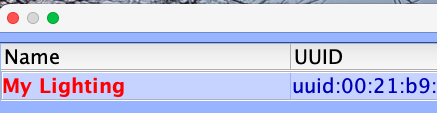

And mine shows neither EISY or IoX:
At one point, I had two entries for my single system, but something changed along the way (possibly a "package" update) and it is now a single line.
Edited by oberkc
@raymondjiii usually the "name" is what is the root or actually one under the root when in admin console. You can change the folder name and then clear java cache and run start.jnlp again and it should change the name.
I'm not sure why you have different entries for the same device, but it explains why on a newly installed (computer) they would all show the root. Perhaps you changed the name at some point and the cache or .state files that UD use still have the old name.
I have my root as "eisy" then the folder just under that has a personalized name. When I open the IoX Finder window it shows just the second folder name (the personalized folder name). I only have one system though.
