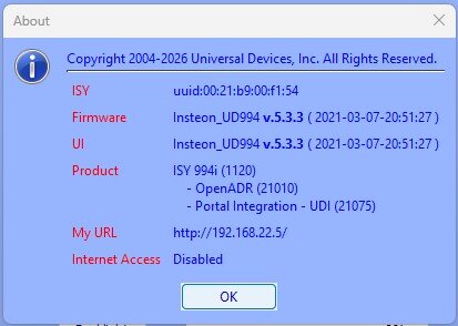

Edited by bwbeisne
adding isy firmware version, fixing typo

@bwbeisne not that it would be the entire answer to your issue since it's "worked" this long, but you're on an outdated firmware. It's a small update from 5.3.3 to 5.3.4. I would suggest you make a backup of your system and update to 5.3.4 to see if there are any fixes in that update that might resovle other underlying issues. The release information for 5.3.4 and the download links can be found here: https://forum.universal-devices.com/topic/33287-534-isy994-last-release-for-isy994/
