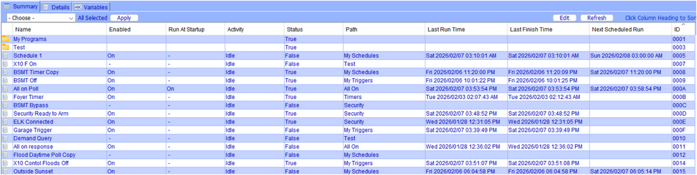

You can always post your programs as well. Many forum members with far more programming experience than myself.

@jim_ , It looks like you have a motion sensor at address 54.68.42 that is used as a control in two programs (0033 and 005D).
Motion sensors send out multiple communication for each trigger event. Yours is sending out 6 separate messages. 4 of the messages the ISY has recognized as duplicates and is ignoring.
Unfortunately two of the messages are being processed causing your programs to re-trigger rapidly. The result is multiple scene 21 on commands.
You may want to add a lockout to your programs (to prevent re-triggering) as well as a delay to prevent the ISY from trying to send out commands while the motion sensor is hammering the PLM with 6 separate communications.

As far as determining the program ID, I typically use the program summary - far right column is the program ID. I'm guessing that the "Parent" that you are referring to is the ID of the Folder the program is in.
Thank you ... The information always seems to be right in front of you, you don't see it

You can also use FIND in the programs area. If you right click on a program and see "Find/Replace" just before "Copy to Clipboard" (see image below). This will allow you to search for many things directly inside of IoX Admin Console. But copying the program to clipboard and searching the text that way is a good way to find things. That's often what is suggested for posting programs to the forums (if you select the individual program and paste it as text it's easier for people to help make edits). Also when you copy the root of the "my programs" folder to clipboard you can save it as text in case your programs become corrupt over time or during a firmware upgrade. These are great tools we've had in admin console for ages...hopefully they will be incorporated into eisy_ui so they can still be used in the future.
