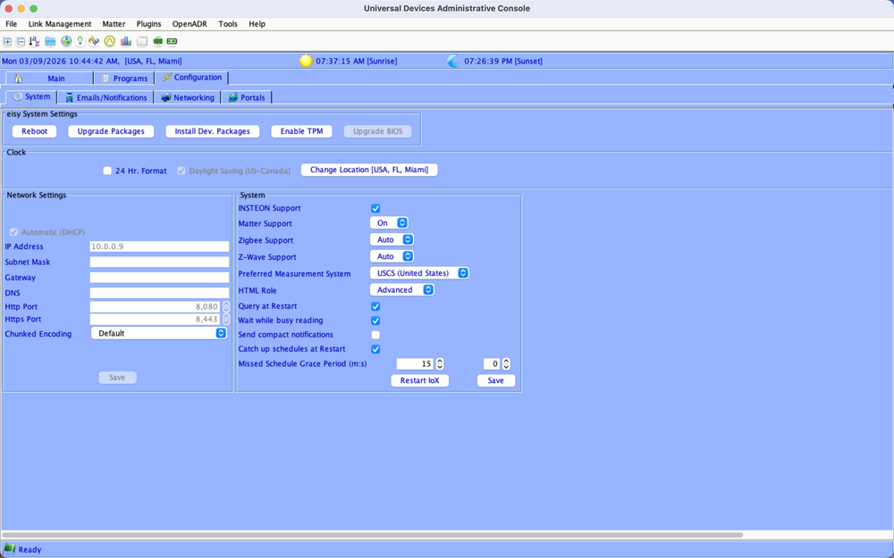

Hello, I'm trying to connect a 800 series Z-wave dongle to Eisy. All of the instructions I can find show Z-wave already listed on administrative counsel. Mine shows matter. It also says to turn on Z-wave in configuration mine is on auto. I tried turning it to on; saved and rebooted but it always go back to auto.I have tried inserting the USB dongle into eisy then rebooting eisy and rebooting Iox. I've done this on both admin counsel and UD mobile but nothing changes. Any help would be greatly appreciated.

Another thing: does your Configuration screen show a "Migrate to ZMatter Z-Wave" button? It should if it's configured to use a Zooz dongle. If not, try doing this from a browser:
