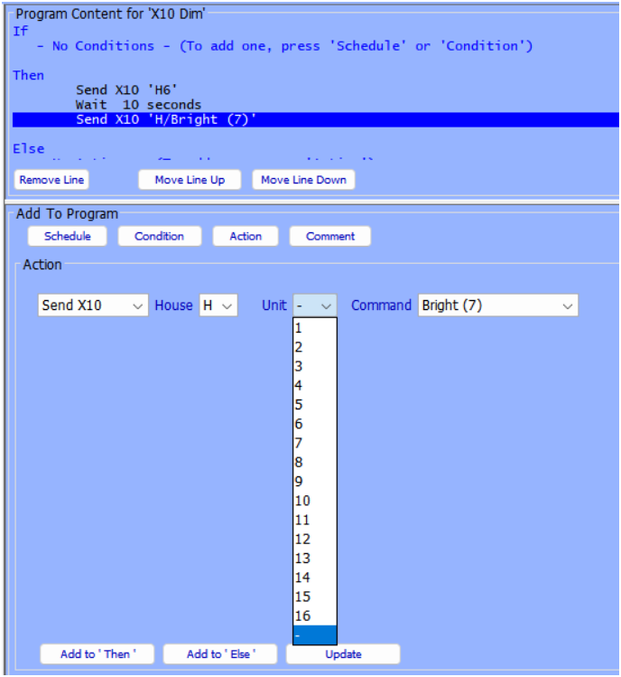

Tuesday at 01:52 PM4 days @hspindel , You can add a delay by executing the House Code and Dim commands separately. By sending only the "H6" command you can insert a delay and then then the "H/Bright" command as shown below.I have no clue if this is related to your issue. Difficult to troubleshoot without a Siren to test.X10 Dim - [ID 0019][Parent 0003][Not Enabled] If - No Conditions - (To add one, press 'Schedule' or 'Condition') Then Send X10 'H6/Bright (7)' (Normal Bright Method) Wait 5 seconds Send X10 'H6' (Housecode address) Wait 2 seconds Send X10 'H/Bright (7)' (Bright command) Tue 04/07/2026 09:44:22 AM : [ Time] 09:44:51 3(0) Tue 04/07/2026 09:44:22 AM : [ X10] H6 Tue 04/07/2026 09:44:22 AM : [X10-RSP ] 02 63 D9 00 06 Tue 04/07/2026 09:44:22 AM : [ X10] H6/Bright (7) Tue 04/07/2026 09:44:23 AM : [X10-RSP ] 02 63 D5 80 06 Tue 04/07/2026 09:44:27 AM : [ X10] H6 Tue 04/07/2026 09:44:27 AM : [X10-RSP ] 02 63 D9 00 06 Tue 04/07/2026 09:44:29 AM : [ X10] H6/Bright (7) Tue 04/07/2026 09:44:29 AM : [X10-RSP ] 02 63 D5 80 06
Wednesday at 12:43 AM3 days Author 10 hours ago, IndyMike said:@hspindel , You can add a delay by executing the House Code and Dim commands separately. By sending only the "H6" command you can insert a delay and then then the "H/Bright" command as shown below.I am sending the commands from an EISY program. I am limited to what the programming allowed for.My current program was a single line:Send X10 'H6/Bright (7)'I changed that to:Send X10 'H6' <no command>Wait 1 secondSend X10 'H6/Bright (7)'This still does not work. On the last line of the program, there is no way to separate the H6 command from the Bright command.
Wednesday at 01:07 AM3 days Author 10 hours ago, IndyMike said:@hspindel , You can add a delay by executing the House Code and Dim commands separately. By sending only the "H6" command you can insert a delay and then then the "H/Bright" command as shown below.X10 Dim - [ID 0019][Parent 0003][Not Enabled] If - No Conditions - (To add one, press 'Schedule' or 'Condition') Then Send X10 'H6/Bright (7)' (Normal Bright Method) Wait 5 seconds Send X10 'H6' (Housecode address) Wait 2 seconds Send X10 'H/Bright (7)' (Bright command) I entered the commands exactly as you suggested, but it still does not work (I did figure for the last 'H/Bright (7)' line you intended 'H6/Bright (7)' as there is no way to send an X10 command without a unit code).Apparently the EISY is sending the commands. Here's the log (with timings showing the delays):Tue 04/07/2026 17:57:16 : [ X10] H6Tue 04/07/2026 17:57:16 : [ X10] H6/Bright (7)Tue 04/07/2026 17:57:16 : [X10-RSP ] 02 63 D9 00 06 Tue 04/07/2026 17:57:17 : [X10-RSP ] 02 63 D5 80 06 Tue 04/07/2026 17:57:21 : [ X10] H6Tue 04/07/2026 17:57:21 : [X10-RSP ] 02 63 D9 00 06 Tue 04/07/2026 17:57:23 : [ X10] H6Tue 04/07/2026 17:57:23 : [ X10] H6/Bright (7)Tue 04/07/2026 17:57:23 : [X10-RSP ] 02 63 D9 00 06 Tue 04/07/2026 17:57:24 : [X10-RSP ] 02 63 D5 80 06 But the siren never chirps. To recap:This used to work. Possibly that was when I had an ISY instead of an EISY.Have tried multiple X10 siren units.Have tried multiple electrical outlets for the siren, including one about 8 feet away from the PLM.Thank you for your suggestions.10 hours ago, IndyMike said:@hspindel , You can add a delay by executing the House Code and Dim commands separately. By sending only the "H6" command you can insert a delay and then then the "H/Bright" command as shown below.Plaintext editor_tool--codelanguageX10 Dim - [ID 0019][Parent 0003][Not Enabled] If - No Conditions - (To add one, press 'Schedule' or 'Condition') Then Send X10 'H6/Bright (7)' (Normal Bright Method) Wait 5 seconds Send X10 'H6' (Housecode address) Wait 2 seconds Send X10 'H/Bright (7)' (Bright command) I entered the commands exactly as you suggested, but it still does not work (I did figure for the last 'H/Bright (7)' line you intended 'H6/Bright (7)' as there is no way to send an X10 command without a unit code).Apparently the EISY is sending the commands. Here's the log (with timings showing the delays):Tue 04/07/2026 17:57:16 : [ X10] H6Tue 04/07/2026 17:57:16 : [ X10] H6/Bright (7)Tue 04/07/2026 17:57:16 : [X10-RSP ] 02 63 D9 00 06 Tue 04/07/2026 17:57:17 : [X10-RSP ] 02 63 D5 80 06 Tue 04/07/2026 17:57:21 : [ X10] H6Tue 04/07/2026 17:57:21 : [X10-RSP ] 02 63 D9 00 06 Tue 04/07/2026 17:57:23 : [ X10] H6Tue 04/07/2026 17:57:23 : [ X10] H6/Bright (7)Tue 04/07/2026 17:57:23 : [X10-RSP ] 02 63 D9 00 06 Tue 04/07/2026 17:57:24 : [X10-RSP ] 02 63 D5 80 06 But the siren never chirps. To recap:This used to work. Possibly that was when I had an ISY instead of an EISY.Have tried multiple X10 siren units.Have tried multiple electrical outlets for the siren, including one about 8 feet away from the PLM.Thank you for your suggestions.
Wednesday at 12:06 PM3 days @hspindel ,Let me start by saying that I'm using the ISY994. It does allow me to send the "Bright" with only a House code as shown below. The result is different and allows a delay between the two commands.I can't say for certain that this option is still available on the EISY, but UD normally keeps items like this consistent across their platforms.I also cannot say that it will help with your problem.Which specific X10 siren are you using?Wed 04/08/2026 07:58:45 AM : [ Time] 07:58:47 4(0) Wed 04/08/2026 07:58:45 AM : [ X10] H6 Wed 04/08/2026 07:58:45 AM : [X10-RSP ] 02 63 D9 00 06 Wed 04/08/2026 07:58:55 AM : [ X10] H6/Bright (7) Wed 04/08/2026 07:58:55 AM : [X10-RSP ] 02 63 D5 80 06 Edited Wednesday at 12:20 PM3 days by IndyMike
Wednesday at 10:59 PM2 days Author @IndyMike Thank you for the reply.The X10 siren is an X10 SH10A Powerhorn.I had not noticed that I can send a house code without a unit code. That capability is available on the EISY as well. Thank you for pointing that out, and I modified the program to not send the unit code.Sadly, the siren still does not make any noise despite seeing the X10 commands in the EISY log, and seeing X10 responses in the log as well.
