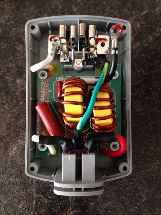

several of the Insteon FilterLinc's died.
If haven't opened them up, there's a fuse in there. They could have been used over their spec'd rating, possibly inrush current turning them on

There was for a short tine a five amp version. After examining both version. Only thing I found was a different fuse and a higher price for the 10Amp model. 10Amp, fast blow, 5mmX20mm axial leads, ceramic body. There was a post here a long time ago. Where a member found bad solder joints on the heavy coil leads and re soldering them to the PC board made them operational again.

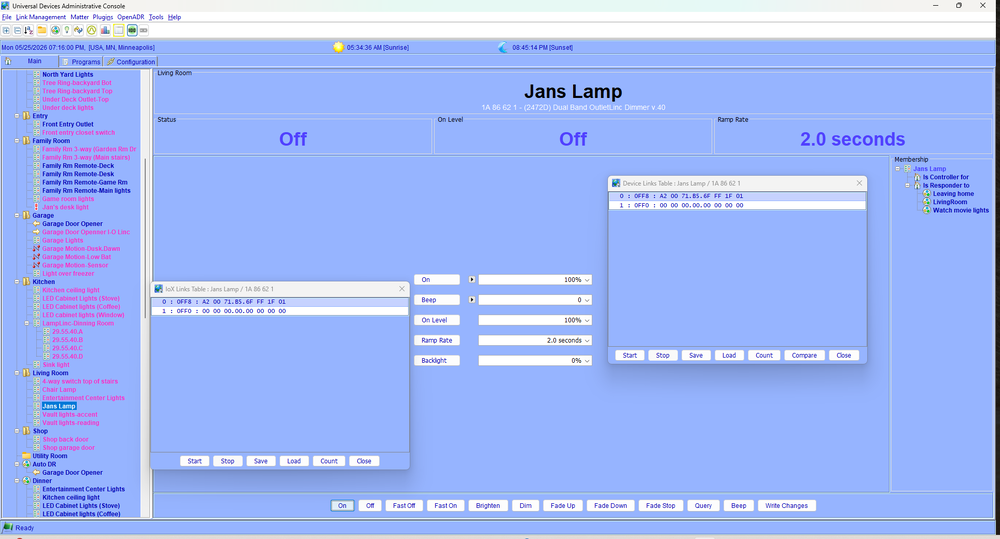

@IndyMike Had to look up how to do a level 3 Event log. Think I got it. One of the devices that I can't get to communicate is the Jans Lamp I tried including before. Did another restore for that module (node) and ran the Event Viewer log. What the log has to say is above my normal grade.

It looks like that completed correctly. Unfortunately, the ISY only wrote 1 link again. It looks like the isy image for this unit may be corrupt. You can view by right clicking on the device tree and selecting /advanced/show is table. If this only shows 1-2 links you'll need to delete and re- add the device
I think we've achieved the point of delete and attempt to add back. I did get a couple devices to respond to EISY commands but there are several remaining such as Jan's lamp (lamp on end table where she reads) that just do not respond. Shows status but no response.
See attached screen shot.

To be clear, your device is responding rather well. It's the ISY that is wriwriting incorrect information due to a corrupted file. Nothing wrong with the device itself.
In the end the result it the same - delete device/re-add.
