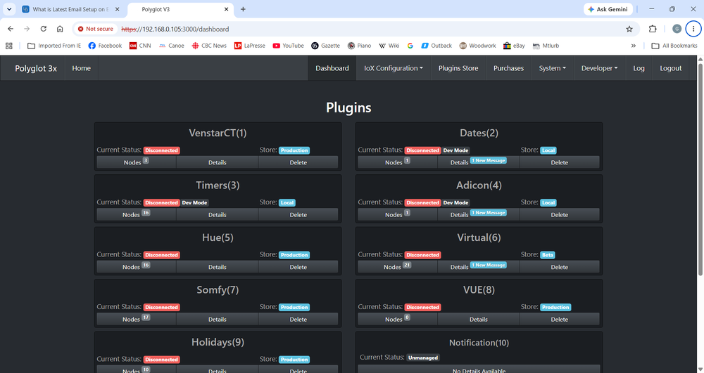

I can't see Plugin Store option at all...
You need to click on "Plugins" at the top, and select "Launch Polyglot V3". You then get a login menu. Log in there, and you'll get the dashboard. Click on "Plugins Store" and you should see the list of plugins you can get. If that works, it's accessing the internet ok.
Ok! i guess i was 'on my way' there, but i thought Polyglot was another variation of ISY, different animal... never had anything to do with it...
I'll be back!
It is asking for ISY password, not EISY password, which is kind of weird, but I tried both the ISY and the EISY PORTAL, neither work.
Edited by johnstonf
7 minutes ago, Guy Lavoie said:
It's asking for your IoX login. That's usually admin... Try admin for both user and password.
That was it, it needed admin for username...
Can I assume by the attached ScreenFlow that it is connecting OK?
Yes, so it's accessing the internet ok.
