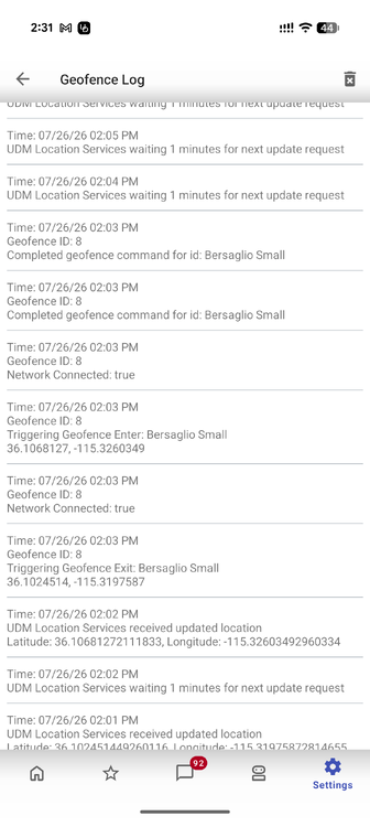

The screenshot of UDMobile GeoFence log shows there was a quick bounce putting me out then right back in, to try and null these out I have it run the same program then/else so if the "out" triggers, and kicks the "else", then the "in" triggers and kicks the "then" and both have a 2 minute delay, I thought the second trigger would kill the first and keep me in? But this doesn't seem to be working.

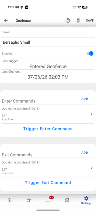

and the screenshot for the GeoFence setting is here which run those programs.
But after the out/in shown in the log the s.HS.Home.Small.Jim stays at 0.

Looks to me like the enter event is dropped or executed out of sequence after the exit bounce. You could add some way to trace the sequence of executing your program. Maybe the history of program executions in UD Mobile could provide a clue.
