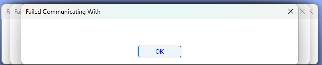

7 hours ago7 hr OK, after upgrading to IoX v.6.1.1 my programs have stopped running. I looked at the programs and see several say Activity=- Not Loaded - and Status = Out of Memory. I never had this issue before. did the eISY come with less memory than the ISY994 or Polisy? My programs are quite small and I mostly rely on scenes. I also get about 50 windows that come up saying cannot communicate with... that I didnt see before, yet I am able to communicate with the Insteon devices.

5 hours ago5 hr Author updated java, cleared cache, used what I believe to be teh latest launcher per above and am getting 26 of these again

4 hours ago4 hr Author I did not unplug but I did reboot. Restoring IoX did another reboot and it seems to be proceeding to update the modem now. However this nessage just popped up but the system busy progress indicator is still progressing.

35 minutes ago35 min Author OK, I tried factory resetting two Keypad Links. Both were 8-button but one was updated to 6 Button. I thought restoring might also convert it back to 6 button after the factory reset. I tried restoring both and it seems like eISY is doing nothing.This is how they both looked before the factory reset and this is how they still look after the factory reset on both and after selecting Right Click, Restiore Device and Yes I would like to proceed. It is like I never selected restore devices. When logging out and back into IoX i and still getting many "Failed communicating with, so maybe the PLM Restore didnt work even though the PLM Event Viewer Links Tables and other items under Tools Diagnose look like there are no issues.I think this may be a good time to re-look at my naming convention for all devices and maybe start from scratch. My preference would be to still figure out what is going on, fix and then make updates to clean up naming convention of devices Edited 32 minutes ago32 min by epete
