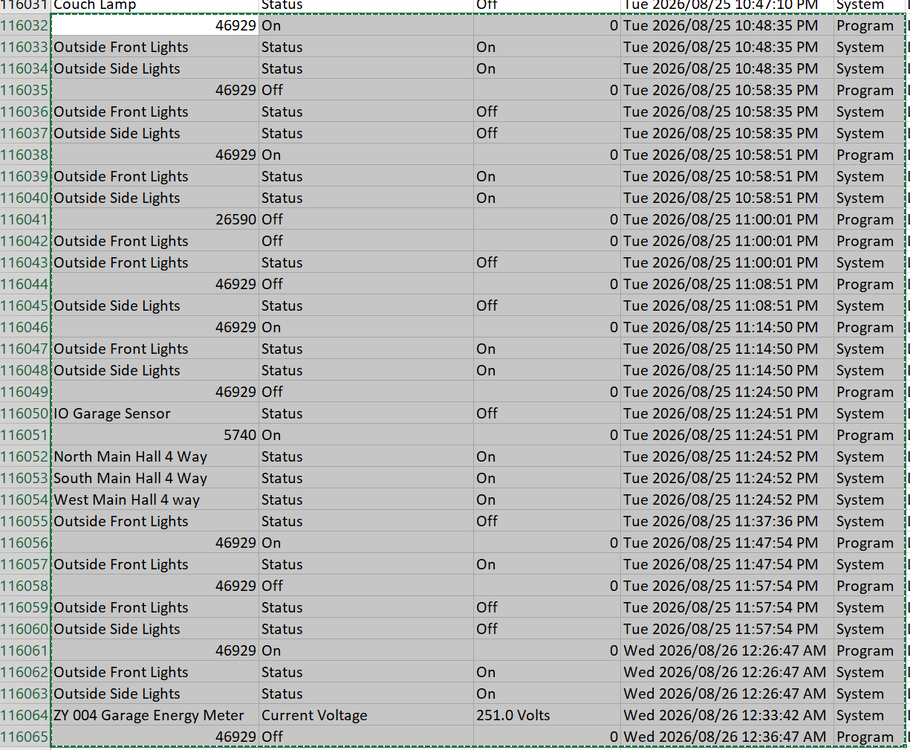

Also interesting, the logs shows scene IDs instead of scene names around the time of the event. I checked the logs again later this morning and they're gone.
Hard rebooting everything.
