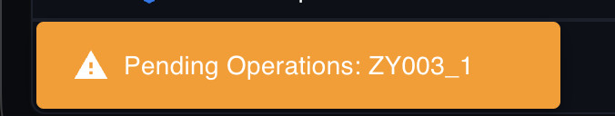

September 4Sep 4 Author Thank you for your help.I reviewed the info and backed everything up. I then performed the upgrade from the Java console and it seems to have gone through just fine. But I'm having issues.Issue #1: When I load the web UI, I now get this error in the lower left corner. It's clearly talking about one of my ZWave devices, so I'll have to chase that down... that's never been a problem before.Issue #2: The programs no longer control my Hue lights at all. I can manually control them through the UI but the programs do not trigger them at all. Other things with the programs trigger (insteon lights and switches) but the Hue light bulbs no longer trigger, even when I right click and say "Run Then" to manually trigger a program. I don't get this as I can manually control them from Nodes. This same exact behavior is true from the Java admin console.Well, now I'm seeing what happened. It basically abandoned the Hue nodes that have been there forever and created new Hue nodes with different IDs. It also dropped the 0-255 light value and is now running on a 0-100 range, so I had to rebuild everything... groups are all a mess too, lots of duplicate "unknown group" entries that seem to be dupes of "All Lights", had to clean that up then go back through all of my programs and re-point everything to the correct nodes/devices. That was super annoying.Issue #3: Not sure if this is by design or not but I can no longer access PG3 directly from the web URL (https://eisy.local:3000/), I get this error. Wonder if that's intended because it's now forcing me to go through the new UI, because I CAN get to it from there. Is this normal behavior? Edited September 4Sep 4 by StangManD
September 4Sep 4 Author Issue #1 and question in Issue #3 remain if someone could please let me know if you have thoughts there. I cannot find anything wrong with the Zigbee device that error is referencing, so I don't know what to think there. Thanks in advance. Edited September 4Sep 4 by StangManD
October 1Oct 1 @StangManD please open a support ticket if still having issues. Unsure of the z-wave problem so can't help there.As for accessing the :3000 polyglot page, that's probably by design as UD has suggested not using that for sometime now. It is/was causing issues with how plugins are licensed and connecting/controlling under the hood. The only way (or suggested way) to use polyglot is through the eisy_ui interface. I wouldn't try to use the 3000 port connection beyond this point. If there's something specific you need to do perhaps in your support ticket UD can help you with alternative option(s). https://www.universal-devices.com/my-tickets/
