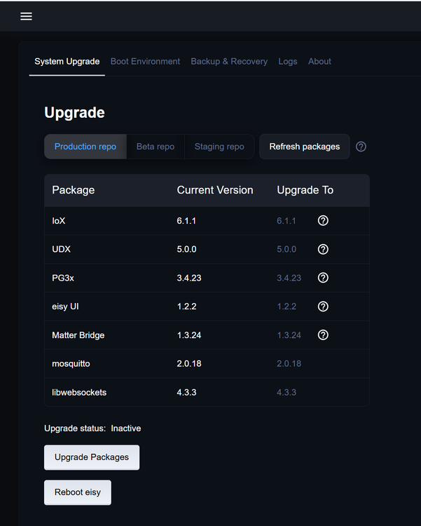

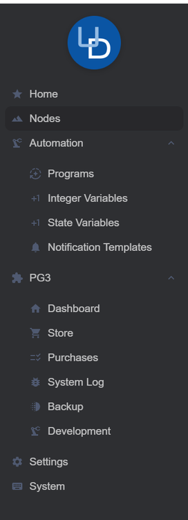

I don't see any way to ADD new devices using eisy-ui image.pngUnder nodes the (+) just adds folders. No love no drama -)
