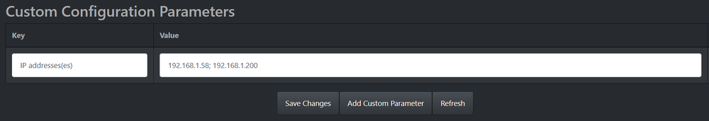

September 20Sep 20 It supports multiple thermostats. I have 3. I put their IP addresses in config separated by semicolons. Edited September 20Sep 20 by hart2hart
October 18Oct 18 Author I still can't get this app to see my new thermostat. I have the IP address typed in as the second entry (my first venstar works fine). the second one, not so much. Polygot shows 2 nodes, but it never shows up in the list of devices in the administrative console. Is there another step I am missing? I stopped, started, restarted, and rebooted. it still does not show up in my list of thermostats. once again, the first one shows up fine.

October 19Oct 19 Author I have tried it with hostname and ip addresses. it still will not see my latest thermostat. It does now show 4 nodes, but the same thermostat shows up twice. with different names. and different ID numbers.Once it shows up in polygot, do I have to do anything to get it to show up in the admin console?
October 19Oct 19 I don’t know if it makes a difference but in the Key, I have “hostname” and you have “IP addresses(es)”
