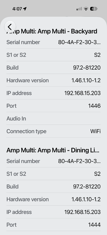

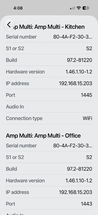

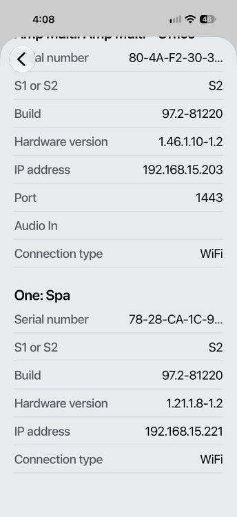

October 23Oct 23 Is anyone updating the Sonos plug-in to support their new multi zone amplifier. It uses one IP address and different ports for the zones.

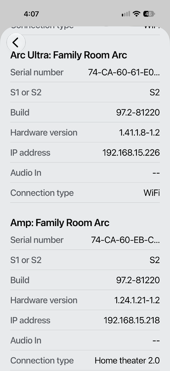

October 23Oct 23 Author Hi Bob. Thanks for the plugin and responding to my post.My coding is rusty but I can act as a testbed for your plugins. I have an Amp, Amp Multi and Sonos One. There is also an updated plugin on HA which works with Amp Multi.
October 26Oct 26 The library being used for the sonos (udi-sonos-poly) plugin was updated a couple of weeks ago to add support for Amp Multi, but I don't really know what that means.I can attempt to update the plugin to use the latest version of the library.

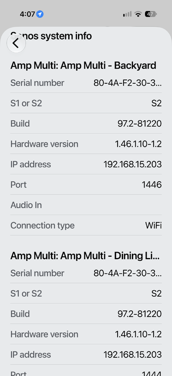

October 26Oct 26 Author That's great. They changed the way they address the speakers so discovery doesn't work. The Amp multi uses one IP address and different ports for the speakers. The attached may be helpful. ha-to-eisy.zip
October 26Oct 26 Yes, that's very helpful. But it raises some questions on what's the best way forward. I see a couple of options.I can try and update the existing sonos plugin. It seems possible, at least the discovery of zones part looks pretty easy. But the existing sonos plugin also allows for manually specifying the zone in the config parameters. Converting that to work with Amp Multi looks to be more of a challenge. There are also other areas of this plugin that could/should be updated as well.Use the generated plugin from ha-to-eisy.zip to create a new Sonos plugin (possibly replacing both ST-Sonos and Sonos). I do see some issues in the plugin that would need to be corrected and it seems to be based on outdated PG3 plugin designs. I'm leaning toward option 2, simply because it seems like the work needed is less and it already has the missing features from the Sonos plugin.Where did ha-to-eisy come from? I can't find anything in the .zip file that lists the license, author, or url to find out more about this. I'd like to make sure that it's ok to modify and re-distribute the code.

October 27Oct 27 @Howard Will you please explain (for dummies like me) what the multi zone amplifier does? I know that the ST-Sonos plugin had a problem with the various speakers joining the wrong zones. Does the amp solve this issue? What are the advantages of the amp?@bpwwer I can't migrate the ST-Sonos plugin to eisy-UI. I've read in these forums that it's not ready to so yet. Are you involved with moving it and, if so, is there a timeline?Thank you both,Ross
October 27Oct 27 Author Hi Ross.It's very new and just being introduced in Canada. It's essentially four AMPs in one. One IP address and individual ports for each zone. It has audio enhancements and some minor limitations like lack of HDMI and inability to use a zone as rear speakers for an ARC Ultra.Sonos Amp Multi—The Multizone Amplifier

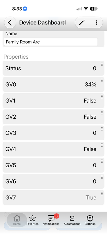

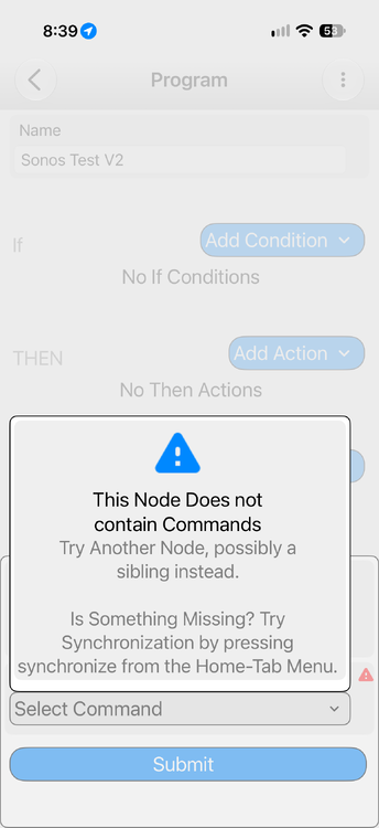

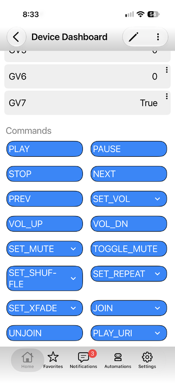

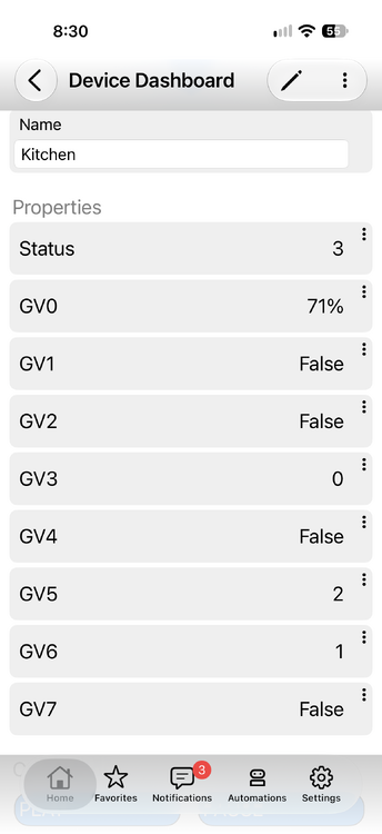

October 29Oct 29 Author Hi Bob,It looks promising and I had some success with the new version. I could control Kitchen through the mobile app (stop, play, volume) but I couldn't do it for the Family Room. I couldn't select a command from a program. I restarted the plugin and attached the debug log and a copy of the nodes.I'll continue to try things and let you know.Thanks,Howard Node Details V2.pdf SonosV2_10-29-2026_83659_AM.zip
October 31Oct 31 I've been making a few changes and I've pushed them up stream so they are available. You just need to re-install to pick up the change. But I'm still having some issues getting things to work properly.I'm starting to think it may be easier to go back to the original code and just incorporate some of the code from the backend.py file so that it's gets the Amp Multi support. I may attempt that over the next couple of days.

November 3Nov 3 Author Hi Bob,Like you I had to use both UDMobile and eisy-ui to get things to work. In your first iteration of V2 eisy-ui might freeze when in the 'add command' dialogue but it could be done in UDM. After going between them I was able to create a program to test for Kitchen or Backyard playing and then turn a Keylinc button on. I made another program to stop Kitchen and Backyard when the Keylinc button was pressed. They worked well. When I played either speaker the button would turn on within the polling period (1 minute). When the button was pressed the music stopped.V4 fixed the UI problems but it broke the EISY node status. It shows all of the attributes however neither program works. The EISY node displays 'playing' when the speaker is stopped. The plugin node has the correct ST value for stop. I checked other values like Bass and Volume. They look good and change when I change them in the Sonos app.Do you need logs or screen shots?
November 6Nov 6 I think I found and fixed the node status. Do a re-install and it should pick up the fix. I didn't change the version number.
