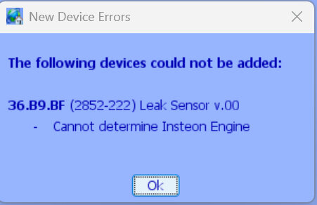

As a follow up to my last post. The linking method using the 'Link a Sensor => Leak Sensor' method instead of the 'Start Linking' icon worked for the Leak Sensor that was still in a box. However, when I tried to link the one that I have been using for several years, I received an error... "Cannot determine Insteon Engine" (see screenshot).
Any idea on why this is coming up?
Note that after getting this I tried resetting the sensor and retried the linking but got the same result.
Did you type in the Insteon address? More than likely one of the "B"s is actually an 8 (eight). I'm not sure if the battery leak sensors can link without typing in the address, but try an alternate putting ".8F" then try ".89.BF"
Edit: I see @larryllix commented on another post that 8 could also be 0 (zero).
"Cannot determine Insteon Engine" usually indicates one of two issues, either the device is out of range of the PLM or you're inputting an incorrect device address when linking

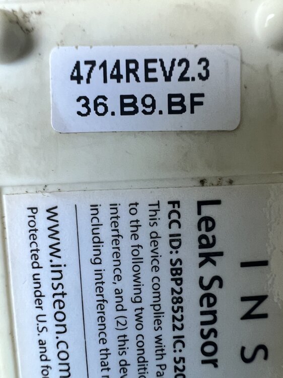

Yes, I typed in the Insteon address. The New Device Error box in my previous post shows the address I typed in. My device clearly shows the address as 36.B9.BF (see pic attached). However, I did go ahead and try every combination of replacing the B's with 0's and 8's but each attempt resulted in the same error.
See above for the incorrect address issue and I have the sensor about 3 feet from the PLM as I try to link it.

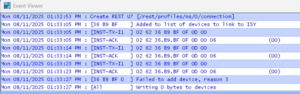

I just tried to link the sensor with the Event Viewer running and here is what I see:
I understand that I should see, in the viewer,
- Inst-TX;
- Inst-RX; and then,
- Inst-SRX
It doesn't seem to be getting past the Inst-TX. I'm not sure what that really means but it does not appear to be good!
The "failed to add device, reason 3" I believe that error 3 is "Device returned invalid node"
Being that you have the correct device address 36.B9.BF, you should try removing power from the eisy then try installing again, but first do a factory reset again on the sensor.
When the sensor is in the linking mode (slow flashing led) is the led bright?
Also take a look at your device tree to make sure the device wasn't previously installed.
