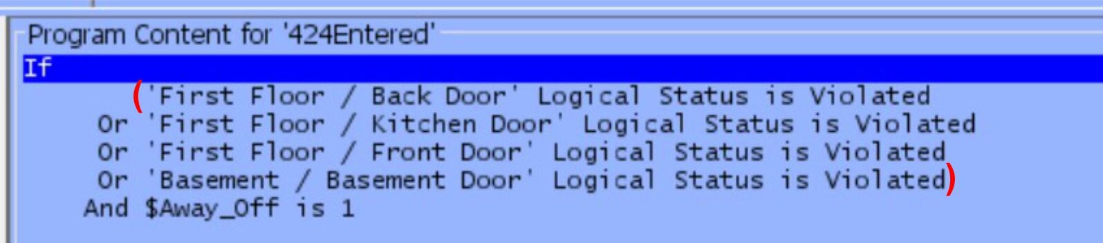

I need some advice on a program.  I have uploaded two screenshot.  PGM1 is the program that exists, but doesn't work as I intended. Yes, I am using the Elk plugin.
PGM1.thumb.jpg.e639e6bc56645e27b8d26c2c79b9a117.jpg PGM2 (note the red parenthesis) is what I wanted to do, but there doesn't seem to be any way in the eisy programming language to do it.
Could some nice person tell me how to do this.
Solved by Guy Lavoie
In the Program content window (top window), click on "Add And (..)" at the bottom right corner. This will add two parenthesis  lines to your program. Then move the parenthesis lines up or down to where you want them.

Copy and paste the program like this?
424Entered Copy Copy - [ID 0021][Parent 0001]
If
       |     'First Floor / Back Door' Logical Status is Violated
       |  Or 'First Floor / Kitchen Door' Logical Status is Violated
       |  Or 'First Floor / Front Door' Logical Status is Violated
       |  Or 'Basement / Basement Door' Logical Status is Violated
    And $Away_Off is 1
Then
        Send Notification to 'Email' content '424Entered'
Else
Send "424 Entered" message if "Away Off" was triggered by garage keypad.
The parenthesis seems to work, too.

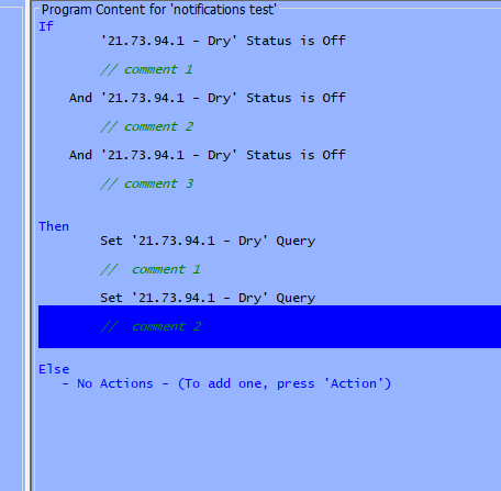

Is there a way to comment each line of a program?  That would be really nice.
I've wished for that too.
You can add as many comments as you want.  They show up as blocks in between each line of code.
You can comment lines between lines and also comment the whole program. These are found in different portions of the edit boxes.
