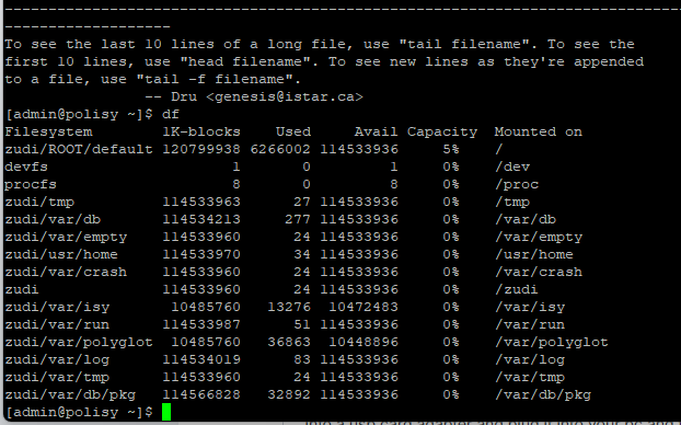

Two ways I know,  The easiest is to ssh into eisy/polisy and issue the command df.  The other is to take your ssd out, put it into a usb card adapter and plug it into your pc and then go to computer management and click on storage/disk management and it will show you.
As you can see here I am using ~6GB out of ~120GB.
