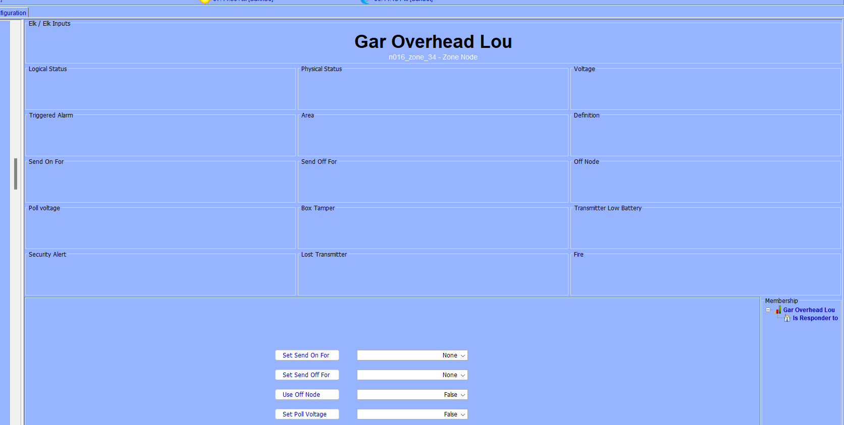

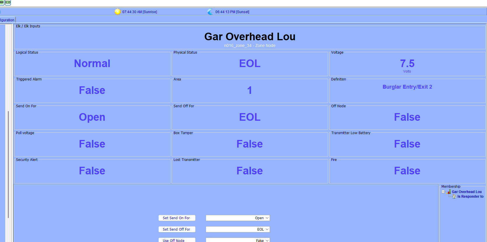

October 31Oct 31 Author So I have isolated the problem to logging in via the portal user/password. Anything that uses the portal (UD Mobile and admin console not using port 8080). For example.This screenshot is from logging in using port 8080 admin/password@bmercier And simultaneously on another computer using the portal login.

November 3Nov 3 Author To further this, it is not just Elk. It is seemingly random nodes across the entire system. Insteon nodes, PG3x nodes, Nodes from IoGuy Nodelink. I see no pattern to it. @Javi Example:Admin console on local connection:Admin console as viewed via portal login at the exact same time from different PC:
November 3Nov 3 Makes sense. There are 2 issues, Property Value Formatting and Missing Property Values.We are still looking into the cause of both issues.Missing Property Values has been replicated on Portal Connections when going through EisyUi***, EisyUi local, and Admin Console Local on port 8443. ***Firmware 6.x and greater use EisyUi for portal connection and the Admin Console when Local on port 8443.Local connections on UD Mobile uses port 8080 so does not use Eisy UI, same with Admin console when using port 8080. If using UD Mobile on Portal clicking into the Device Dashboard will perform a new Property Value Query. While not ideal it is the current work around until fixed.
