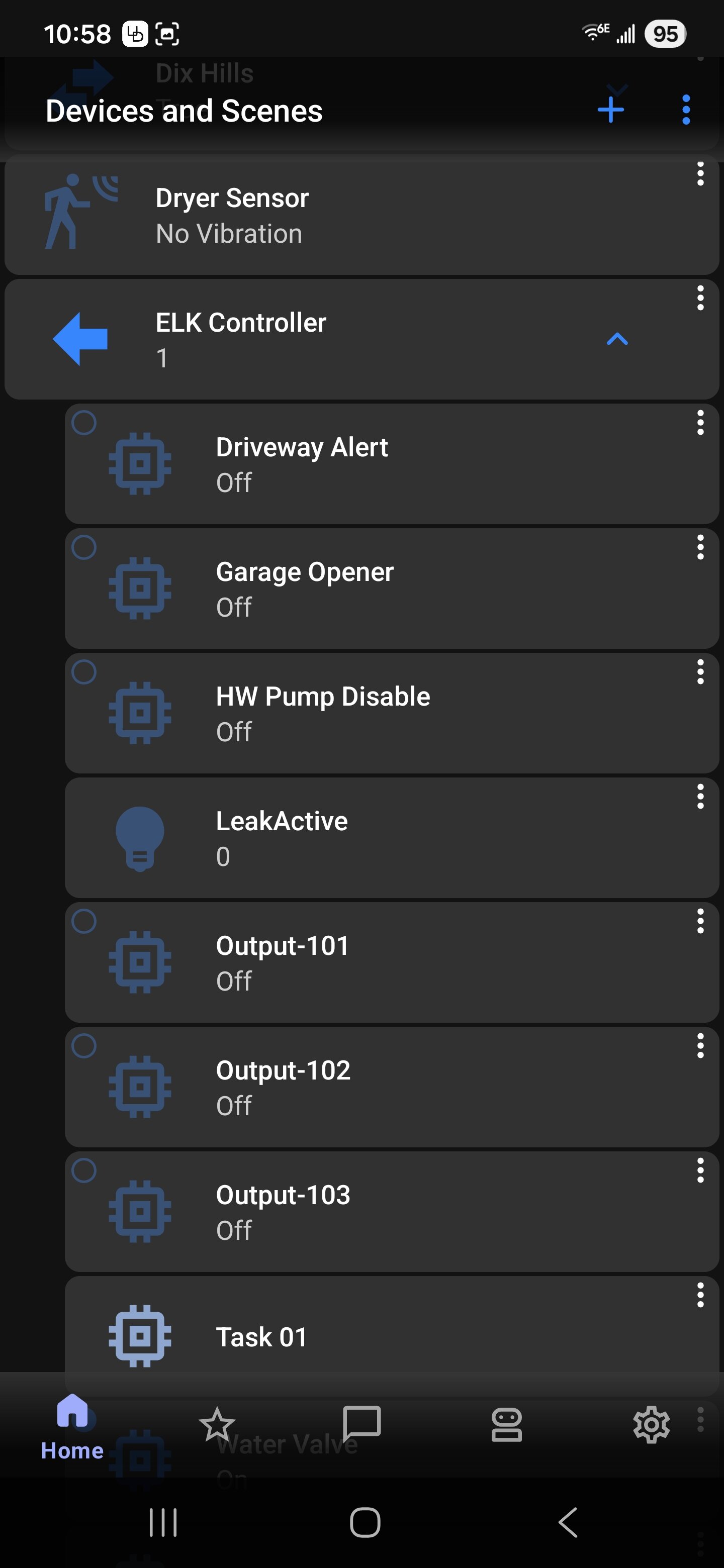

Not sure if this is an issue with UD Mobile or Elk plugin, but after updating to IoX 6.0, UD Mobile is displaying numeric values for certain fields, including Armed Status, Arm Up State, Chime Mode, Physical & Logical Status, as well as some others.
I have synchronized, rebooted eisy, and synchronized again with no change. Please see screenshots.

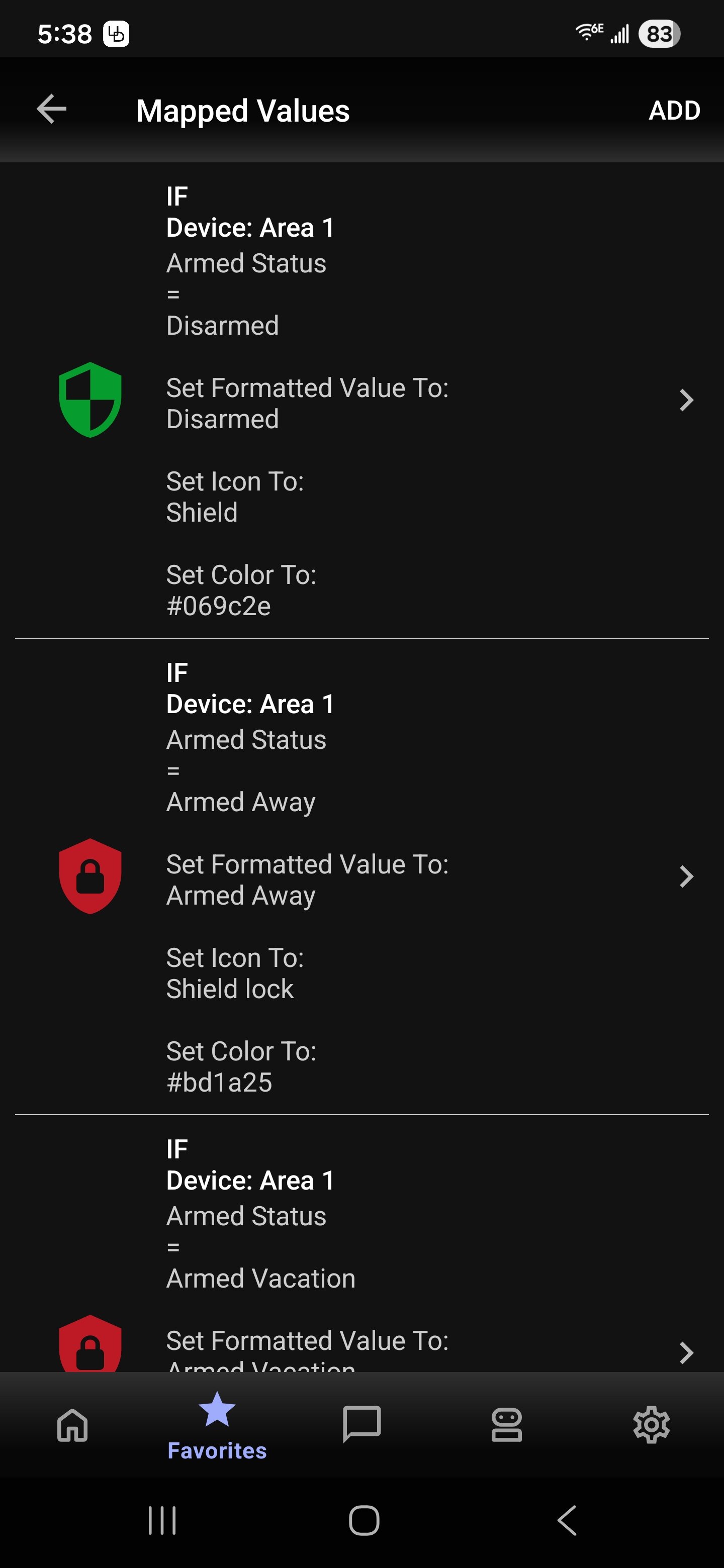

11 minutes ago, MMAltair said:
Now it only displays a number. This problem would be solvable using Advanced Status except there is no way to do a comparison against the number value that is returned.
See how I did it from the attached screenshot.
See how I did it from the attached.
Okay, that fixed it. Before 6.0 I didn't need to explicitly set the displayed text in Advanced Status.
Thanks for the response!

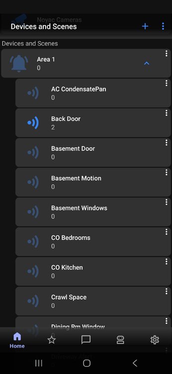

When I go to Add then equals I do not get the same options you get (like disarmed and armed away and armed vacation). I get type of alarm, like fire, burglar and so on.
Are you on armed Status?
Hi Dennis,
I go to Home screen, Home (my area 1), hamburger, Configure, then Add...then 'if value is null' change to equal to, Then under equal to I have All the different alarms listed. but no armed status.
John
11 hours ago, JSchumann said:
Hi Dennis,
John
What you are seeing would be normal.
You would need to follow the wiki instructions to create a Favorite. On the favorite page, click the + sign to create a favorite with a custom name. For example, Elk Area 1. Next go down to Display Node and navigate to Area 1. Now move to Display Status and select Armed Status.. Then it Save in upper right.
Once this tile is created, you can then follow directions from my post above to add mapped values.

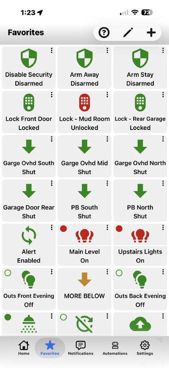

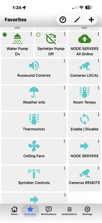

@JSchumann In addition to the above on favoirites, I have created folders that link to other pages of favorites: Sprinkler system, or thermostats, or weather info etc. This is my main page.. the blue items are folders that take me to other favorites.
Its pretty powerful, but again, BACKUP after changes.. I have lost many hours when things have "disappeared " as UDM is being developed.
Wow, just wow!!!! Thanks!
