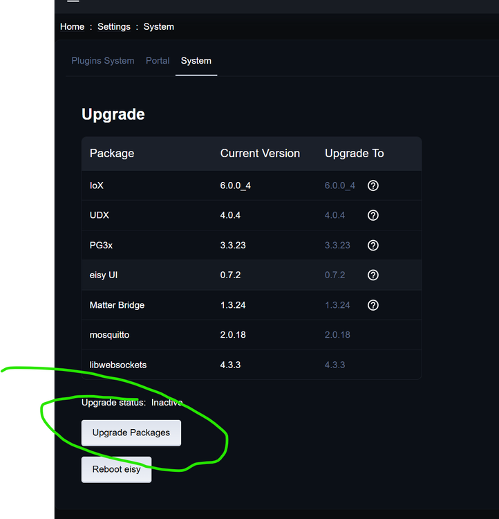

November 16Nov 16 To watch the update progress, ssh to it and type tail -f /var/log/messagesIf it pauses for too long, login to admin console and see if notification requires a reboot.Nice if they would have some sort of status in web UI.. .I just updated (was already on version 6) and the new version has upgrade packages button in the eisy-ui so I will check that out next time. Edited November 16Nov 16 by brians
