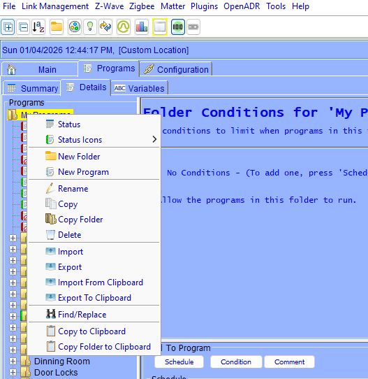

My simple suggestion is to make a back up of the system, but also make a backup of all your programs (right click the “my programs” root and select copy folder to clipboard. Then paste that as text in a text editor (not a word processing program so it keeps text unformatted). Save that file as a back up of all your programs!

BTW, I tried to heed your advice about backing up my programs, but can't find the “my programs” root to which you refer; I wonder if I'm running into Mac/PC differences. (Right-clicking ain't a normal Mac action, but Ctrl-click allegedly does the same thing. However nothing I right-click on yields what you're describing.) Am I looking for some files outside of the Admin Console ("Finder" files, in Mac parlance)?
