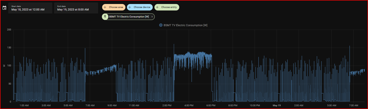

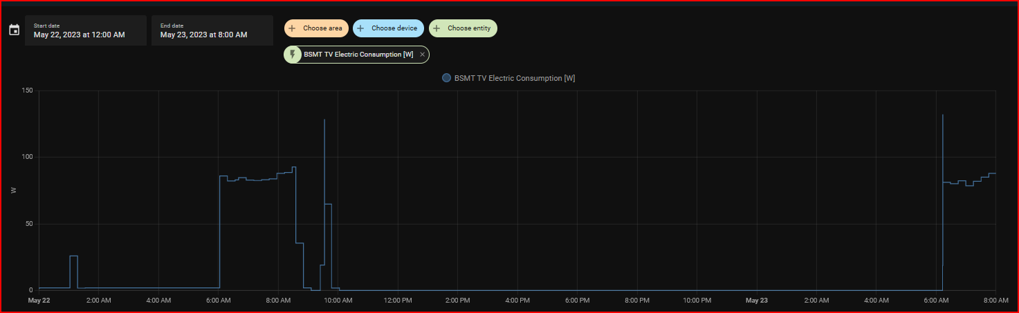

As @lilyoyo1 indicated, some Z-wave devices have features that (if set incorrectly) can overwhelm the system with excessive communication. I purchased 4 Zooz ZEN04 power monitoring plugs for monitoring/shutting down various TV and appliances. They worked well in most locations after setting the parameters for monitoring power.
My Sony TV did NOT play well with the device regardless of the parameter settings. The communication would hit levels that would cause the system to become sluggish. Disabling monitoring instantly returned the system to normal.
I communicated the problem to Zooz and they rolled out a firmware update with additional tuning options. The result is shown in the second plot. System performance is night and day different. I am still running this system today.

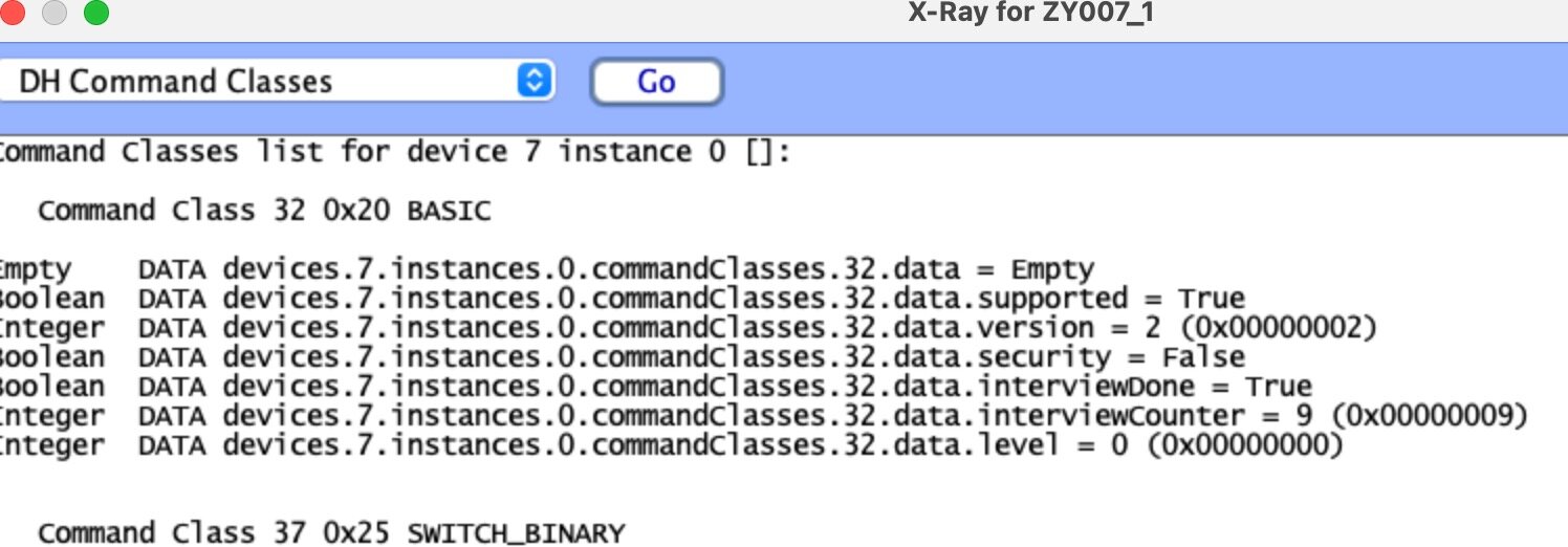

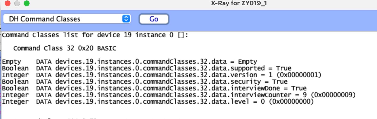

Trying to determine if my locks are using the proper security, I ran Xray DH Command Class on one of hte locks and then on a wall wart plug and a zooz relay switch.
Not really knowing what I am looking at, I do see a difference between the lock and hte others. Specifically in the fourth line which has the word SECURITY. in it.
For the lock it says True, for the others it says False.
So @Diesel I wonder if the security is correct and with the EISY zooz stick, it no longer needs the 75' cable / proximity to associate correctly?

@dbwarner5
The SECURITY=True flag in Xray only means the lock is encrypted. It doesn’t distinguish between S0 and S2.
To confirm S2, you'd need to see COMMAND_CLASS_SECURITY_2 (0x9F) or S2 Access Control listed.
Eisy + Zooz 800 stick improves inclusion reliability, but it doesn’t eliminate the need for close proximity during first-time S2 pairing. Including locks next to the main controller is still the most reliable way to ensure a clean S2 handshake.

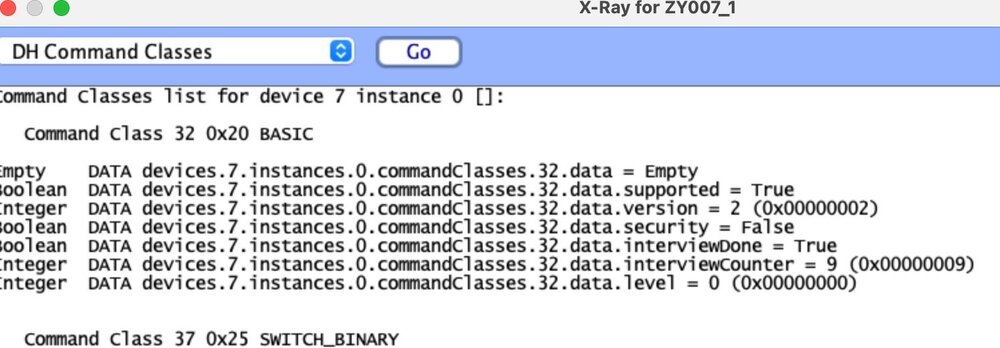

So I guess its S0... but working.. battery life isnt great.. about 9 months.
But it's working and I a ton of programs that relay on the current "node" as well as resources etc.
SO LEAVE IT BE is the answer!
