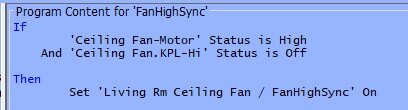

In the process of setting up my FanLink & 5 Button Keypad following https://wiki.universal-devices.com/index.php?title=ISY994i:INSTEON_Device:FanLinc-KPL_FanLinc_KeypadLinc_Configuration#Firmware_5.x ,
I noticed that the program folder path no longer shows up in the program script;
This is what it looks like in the example:
Is this an artifact of the V6.x upgrade? Am I causing this by doing something different?
It does show up on the 'Program Summary' page:

I can not replicate this behavior, both Conditions and Actions show the path in Admin Console on my eisy.
Are you sure the device is in a user-created folder, not the main folder? The default name for the main folder is iOX, but may have been renamed by user, the icon is a monitor. If in this "folder" it is at root.
Thanks Javi; I had the programs in folders, but the devices were in the main ISY folder. I've moved everything fan related into a folder for the living room and now I see the paths.
