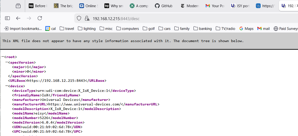

https://1.2.3.4:8443/desc replies "This XML file...
https://1.2.3.4:8443/desc replies "This XML file does not appear to have any style information associated with it. The document tree is shown below."
What am I doing wrong? I am trying to start the EISY-UI screens.

@S. Alexei Gitter or if your router finds the eisy locally even easier to just type: https://eisy.local/
You will probably get a security alert on the browser you're using. You can click advanced and continue to get to the site.

    • I can add the https://1.2.3.4:8443/desc but even then it does not do anything with this
      • https://eisy.local... fails

also ... I still get the "This XML file ... " text when trying to get to the portal ... I can get to the portal through the internet via my.iso.io but I don't want to get there through the internet, I would prefer to do it locally

This was meant to be used on a browser. That launches the eisy-ui interface. Attempting to add this in the Java IoX Finder window will NOT work.
Still possible. Just need to add your device locally. Sounds like you're having issues due to being scattered and trying too much all at once. Pick IoX Launcher and focus on loading that. If you're reading the wiki then it walks you through the process of adding the eisy manually if it isn't found. Are you running VLANs (on your network), anti-virus, or VPNs on your computer?
