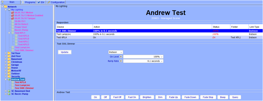

I know this is on here somewhere but I cant find it.
I have a few light that are triggered by their device (SWL or Lamplinc) but are also turned on by a KPL button (not the load)
I have the scene that has the device and the KPL button (as controller)
How do I make the LED light up when the light is on and shut off when the light is off?
I know I'm supposed to add it to the scene but when I try it says its already a member of the scene
Solved by paulbates
I put them both in as controllers now but the LED still doesn't light up when the device is on.
I'm unclear what I'm doing wrong?

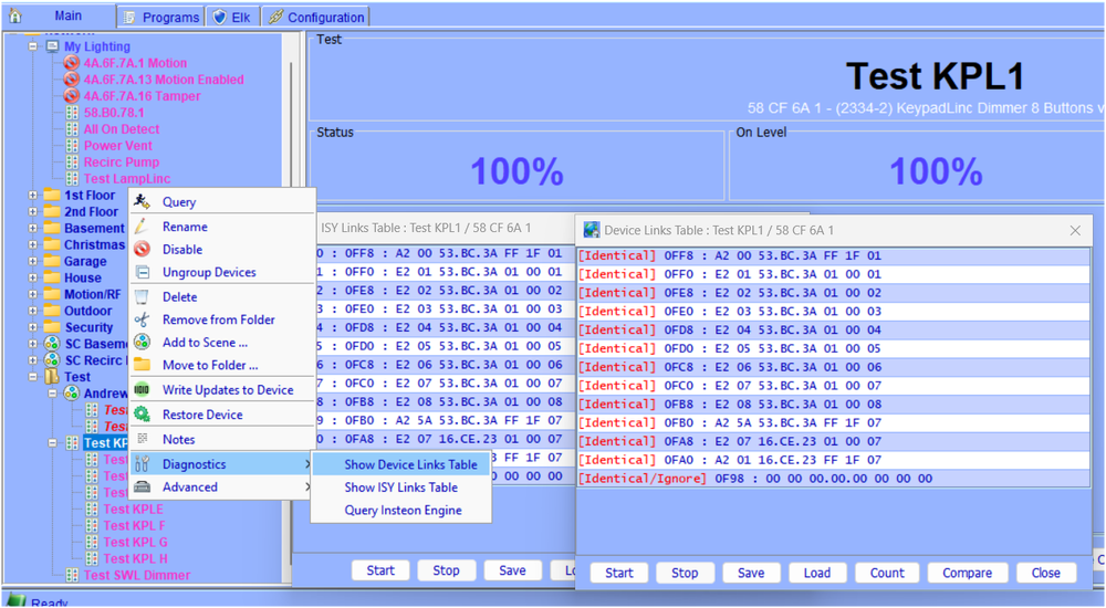

If turned on/off by the keypad, or by the switch/module, the keypad button would reflect this status because of the scene. Is it possible that there is a program that is turning on the switch/module, or that the switch/module is a member of another scene?
To isolate which it is, you can try temporarily adding a 3rd nearby device to the scene as a responder. Switch the SWL - What happens, does the new device also come on?
If the new nearby test device comes on, it's the keypad. Keypads can 'lose their way' after long periods of use. If updating the scene or restore device didn't work, factory reset it and restore device.

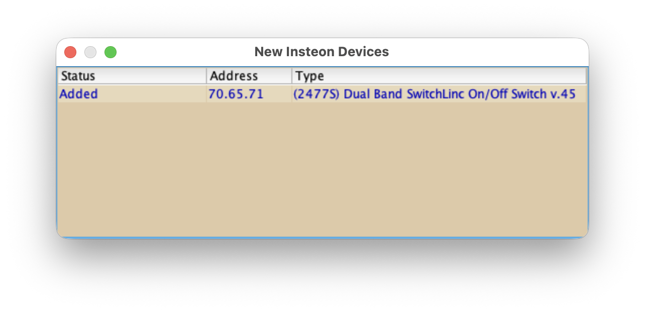

As an aside I still see this when I open the GUI
(its the latest device I added)

@andrew77 , after seeing your event viewer info, it appears you have 1 - 8 button KPL and 1 SWL relay in your scene. I reconfigured my test setup to be similar (1-8 button KPL + 1 SWL dimmer).
Since your devices are sending the correct information to the PLM, and you have excellent communication, that leaves us with a link table problem. This will most likely be in the KPL since the "H" button is not following the SWL.
  1. Please perform a "Link table read" by right clicking on the KPL and the selecting "Diagnostics/Show Device Links Table" from the drop down list. See the graphic below.
  2. The ISY will take some time communicating with your KPL and will fill in the table on the far right.
  3. Once the process is complete, click on the "Compare" button toward to bottom right of the window. In response, the ISY will present a second table showing what it believes "should be" in the KPL link table. It will also highlight any errors.
  4. Please perform a screen copy of the tables and post to the forum.

I've created the table above from the data in my KPL. The items at address FA8 and FA0 are what allow the KPL to control and respond to my SWL @16.CE.23
Note: your KPL will likely have far more links. The addresses will be different. Your SWL address is also different @70.65.71. Even so, this information must be there in order for the KPL to control/respond to the SWL.
Your KPL should have a record matching the following. The "E2" flag indicates that the KPL is a controller of the listed device (your SWL). The 7 in the last column indicates KPL Button G
E2
7
70.65.71
1
00
07
The second link with the "A2" Flag indicates that the KPL is a responder to the listed device. This allows your SWL @70.65.71 to control button G on the KPL.
A2
1
70.65.71
FF
1F
07
Assuming things are incorrect, recovery may be as easy as deleting the device from the scene and re-adding. Worst case would be deleting the device and re-linking (painful for a KPL).
The reason we are going through this somewhat painful exercise is to determine whether the link table is in fact Incorrect. If so, we'll know how to proceed.
The other possibility is that your KPL cannot hear the SWL. We've established that both devices can communicate well with the PLM. That does not guarantee that they can communicate with each other (different phases, etc).

Finally, the admin console opening up showing the last device added every time is a bug in the recent firmware. You need to reboot your iox to get rid of it.
