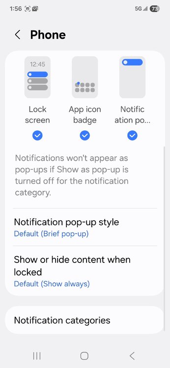

February 25Feb 25 Author On 2/23/2026 at 6:15 PM, Geddy said:@JSchumann the wiki lists what sounds are available:https://wiki.universal-devices.com/UD_Mobile#SoundsSo I do this: Upon receipt of the notification long click the notification displayed by Android, this will show Android Notification Settings. Press settings (gear icon). Then click on any of the notification types (sound names), then click Sounds, THERE is no Select Sounds after pressing the fear icon........See attached image......now select a sound from your device.

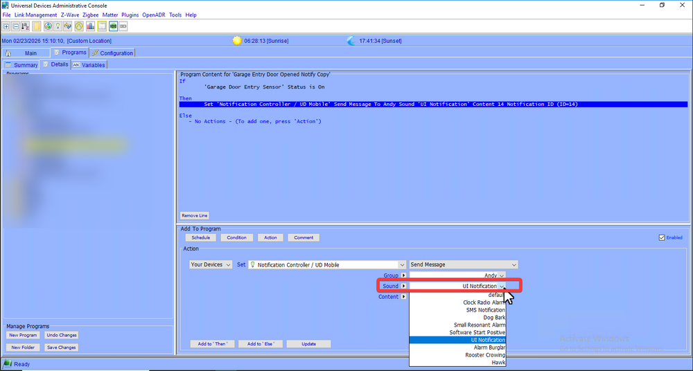

February 25Feb 25 Author On 2/23/2026 at 6:11 PM, atmarosi said:This is where I set it:Didn't work on my Android.....

February 25Feb 25 @JSchumann If you scroll down you should see a line for Notification Cateagories. Clicking on that line will give you more options. If you don't have a line for Notification Categories then you probably have no options for additional sounds

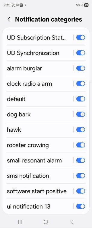

February 26Feb 26 Author 2 hours ago, Techman said:@JSchumannIf you scroll down you should see a line for Notification Cateagories. Clicking on that line will give you more options. If you don't have a line for Notification Categories then you probably have no options for additional soundsThis is what I get for Notification Settings, what do I do with this????
February 26Feb 26 Click on one of the sounds, then enable it.You'll probably have to write a program to apply the sound to an event. UD Mobile - Universal Devices, Inc. Wiki
