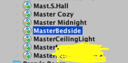

There are no pluses to expand. That's the issue.

Thanks Geddy. I checked from the other machine and you're correct- it's a Mac issue. On Windows, Java is using a "+" icon from deep in a win32.dll somewhere, while in Mac it's using something different. It appears as a down carrot, in a gray color almost the same as the background. So the workaround is click in the "blank" space left of the object to open. Thanks for the tip.

Sad that I keep little tidbits like that in my memory at times. I couldn't put my finger on the post if I tried, but I know there was something about it being very faded or small. This screen shot does show how faded it is. I guess if it were a different theme then it might show better, but can't say for sure. Glad it worked out easy for just being a UI anomaly.
