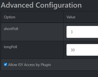

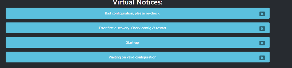

Hi,
I upgraded my Virtual plugin today and I'm now getting 4 error messages. The configuration looks ok, so maybe there are new configuration requirements with V3.1.26? See attached. Thanks for any help!
Edited by tmorse305
Hi @tmorse305 ,
Not sure which version you were updating from but the user, password, & isy fields can be deleted.
If you can pull those out, restart, and send me a log file, I will take a look.
