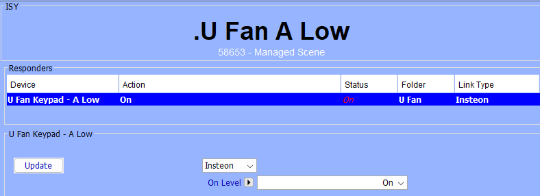

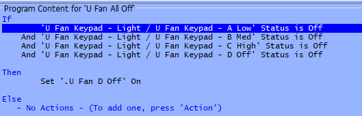

I think everyone has their own favorite setup where Fanlincs are concerned. I have used just scenes but find it confusing because you have to have a scene for every button with every button added. And the individual buttons in each scene have to be set to the correct on/off state. And if one button is set incorrectly somewhere, it is a nightmare to sort out.
I personally find this "scene only" setup confusing. So, I use a combination of scenes and programs.

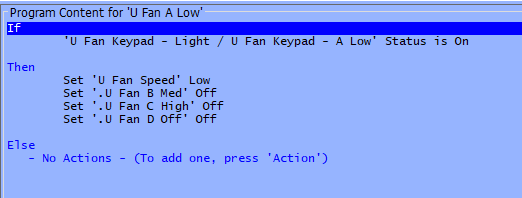

The procedure assumes the Fanlinc has permanent power.

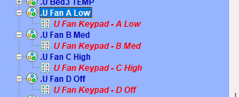

1) Create a scene for each of the A/B/C/D buttons where the only item in the scene is the button as a controller
2) Create a program for each fan speed that when a speed button is pressed, it activates the required fan speed and turns off the other button scenes. The result being "radio" buttons that keep all the buttons in sync.

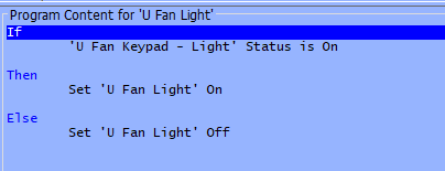

3) Assuming you are using the Fanlinc to also control the light, this light program is just the light button - no scene needed.
4) Finally, I have a "catch all" program for All Off. It activates if you click one of the speed buttons that is already on to off. It activates the Off scene and program. This makes sure that at least one fan speed button is lit at all times.
BTW - the use of the OFF scene and programs is optional with this procedure. To turn the fan off, just click to currently lit speed button. Just remove all programs, scenes and references to the OFF setting. Sometimes an extra button is more valuable than a Fan Off key.

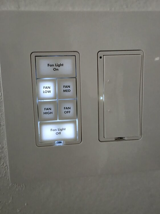

My keypad. Good Luck!
And just for reference, this is the "using scenes only" approach that I used. Each step had to be done for each button. I never use this approach anymore.
