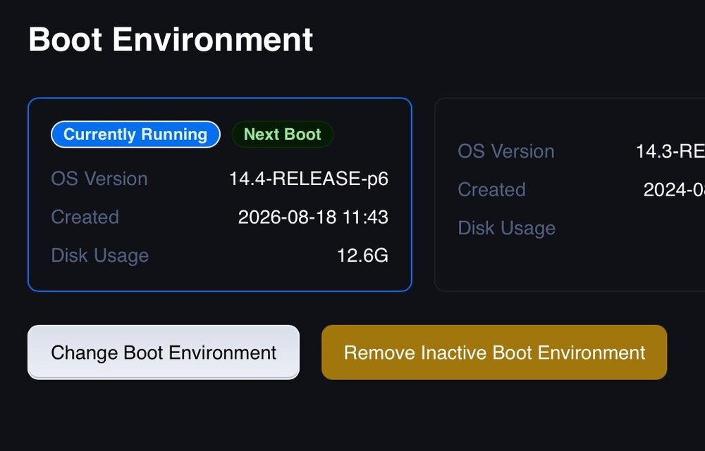

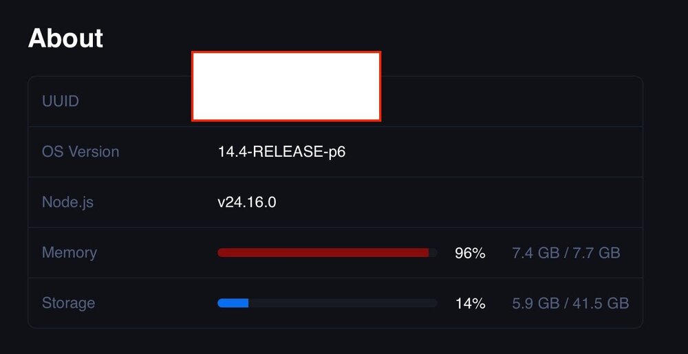

With the New UI, there are two screens that show memory related information. Can someone explain what they mean as they dont seem to be consistent with each other?
The boot environment says the current version is using 12.6G of memory.
Memory usage says that 7.4 of 7.7. is being used --> I assume this is RAM?
But then it says storage is only 5.9 gb... The unused boot (not shown is 5.3 gb)... is this the storage? Then where is the 12.6?

Screenshot 2026-08-19 at 10.11.57 AM.jpgScreenshot 2026-08-19 at 10.11.46 AM.jpg

15 minutes ago, Michel Kohanim said:
@dbwarner5 ,
No! You literally have two disk partitions one of which is called "storage". Boot Environments are not disk partitions. They are ZFS boot environments on the same disk partition.
With kind regards,
Michel
Ok, but is the general idea that after you confirm that the new one has working fine for a while, you can delete the inactive one? Will a new update further down the line then made the current one an inactive one, offering a recovery path again? It's a great feature, making updates less do or die.
