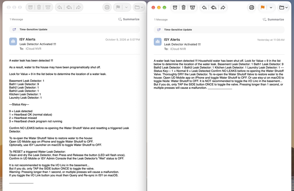

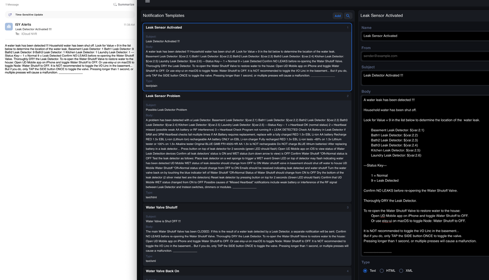

October 12Oct 12 Notification emails configured in eisy.ui are not properly formatted in the emails as sent and received. I experimented by changing the radio buttons for text, html and xml, but the format in the emails did not change. Everything is jumbled together in non-formatted plain text appearing in the email as it is shown on the left side of the screenshot, unlike the right side of the screenshot where formatting includes line spacing and indentation. ISY-994 preserved the rich text format in emails, and that's what I'm trying to achieve again. Is this a bug in eisy.ui or is there something I'm missing ? I'm using the latest production repo 1.2.2.Thanks.

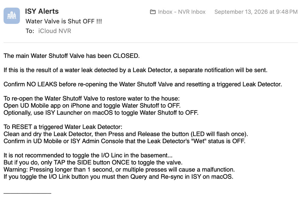

October 13Oct 13 Author The attached screenshot shows two emails as received, the one on the left was sent Oct 9th and is formatted properly. That notification template (text) was migrated from ISY-994 to eisy and it displayed as expected in the eisy program on Oct 9th. Then I edited the notification in eisy.ui changing some wording, but leaving the line spacing as it was, and now the formatting has been stripped out. The radio button was set to text.
October 13Oct 13 14 minutes ago, Spring said:The attached screenshot shows two emails as received, the one on the left was sent Oct 9th and is formatted properly. That notification template (text) was migrated from ISY-994 to eisy and it displayed as expected in the eisy program on Oct 9th. Then I edited the notification in eisy.ui changing some wording, but leaving the line spacing as it was, and now the formatting has been stripped out. The radio button was set to text.Looks like when it is saved in eisy-ui the HTML breaks or tags might be removed. Will need to investigate.Can you post an example from from one that works in Admin Console so I have a test case?
October 13Oct 13 Author 2 minutes ago, Javi said:Looks like when it is saved in eisy-ui the HTML breaks or tags might be removed. Will need to investigate.Can you post an example from from one that works in Admin Console so I have a test case?These emails are being sent by a Program when an "If" statement triggers an event. The attached (Sep 13) email was sent when I was still using the Java based Admin Console, but I'm using macOS Golden Gate now, so I have no option to use anything other than eisy.ui. The earlier email examples were sent from a Program that was migrated from ISY-994 into eisy (and the format remained intact), then the notification text was edited in eisy.ui (and the format broke).
October 13Oct 13 Understood, I need the exact String that works. My guess is something is being filtered out, however this is a legacy method and I don't have custom SMTP setup so I cannot test myself, I can only test that the string is saved typed.

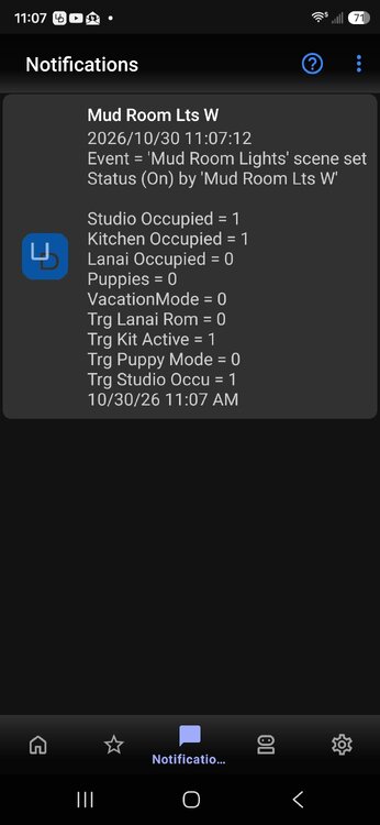

October 13Oct 13 5 minutes ago, Javi said:Please share!Word Hex ShortcutIf you have Microsoft Word, you can turn the hex code line feed into the character using a keyboard shortcut:Open WordType exactly: 2029Immediately press Alt + X together.The numbers 2029 will transform into the invisible LINE separator. You can then copy and paste it where you need it.The Notifications preview window is still unformatted but UD Mobile displays properly.Anyway for now my notifications are now readable.

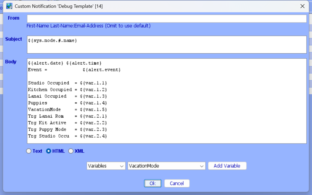

October 30Oct 30 I found that the old Java admin console formats notification UD Mobile text perfectly. It is completely WYSIWYG and updates the new Web UI.
October 30Oct 30 7 minutes ago, skydvrz said:I found that the old Java admin console formats notification UD Mobile text perfectly. It is completely WYSIWYG and updates the new Web UI.Might be due to selecting HTML (not the default)? However this may break other chars.
October 30Oct 30 8 minutes ago, Javi said:Might be due to selecting HTML (not the default)? However this may break other chars.Nope. I just switched the notification to Text in the Java console and re-ran it. There was no change in formatting in UD Mobile.
October 30Oct 30 Replicated, I must had already saved from eisy-ui in the past. Likely next releaseFix ID: universaldevices/eisy-ui/pull/149
