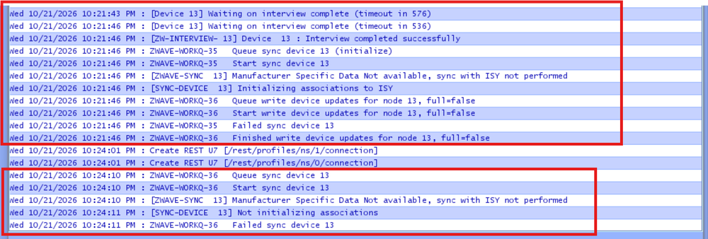

It is device 13 shown below. I have approx 65 zwave devices working.
Top box is Update with interview, and bottom box is just update.

Thanks Javi, but no luck. I sent the zwave capture log to support and the S0/S2 Bootstrap is failing, and it is going through 20 neighbors, even though the lock is 6 inches from the dongle.
Even after excluding, factory resetting the lock, and including.

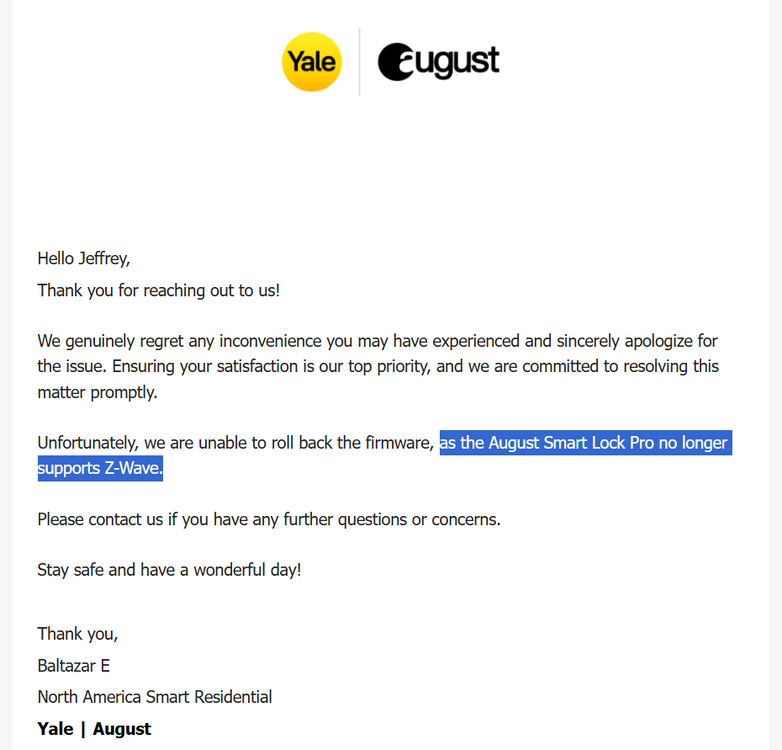

Javi,
Thanks again for your support. I reached out to August and it looks like they have discontinued Z-wave support for their ASL-03 August Smart Lock Pro.
They make No mention of this on their support site, but I found others on Reddit that got the same response from their support.
SO if you run into any August lock issues it is not UD, it is August/Yale which is the problem. Time to find a new lock...
