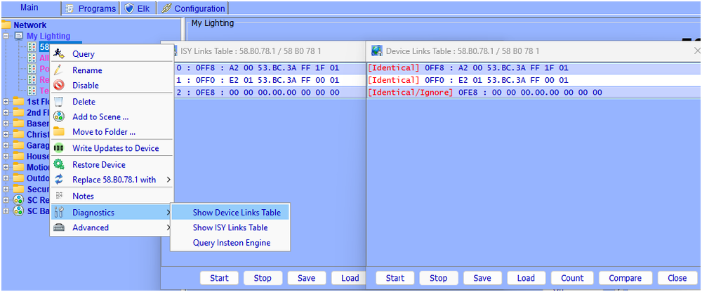

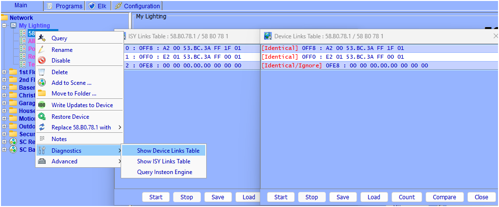

  4. @K-bert , please try performing a device link table read/compare (right click device on Console tree, select Diagnostics/Show device Links Table). Examples below. Bonus is you can have event viewer open on "Level 3" to record communications. Please post the resulting table and the event viewer contents. The Link table will show us whether you have the correct links in the device (Please provide current PLM address). The event viewer will show the communication progression, quality (hops remaining), and any errors encountered. The PLM also requires a link in it's table, but that's a little harder to come by. Please post the above and we'll see if a PLM table read is necessary. The examples below show a link table for a device that is linked ONLY to the PLM (53.BC.3A). It is the absolute minimum # of links for a device to function properly. Link Table Read Selection Link Table Contents Event Viewer Communications Tue 10/27/2026 09:47:12 AM : [INST-TX-I2 ] 02 62 18 93 83 1F 2F 00 00 00 0F FF 01 00 00 00 00 00 00 00 00 C2 Tue 10/27/2026 09:47:12 AM : [INST-ACK ] 02 62 18.93.83 1F 2F 00 00 00 0F FF 01 00 00 00 00 00 00 00 00 C2 06 (00) Tue 10/27/2026 09:47:12 AM : [INST-SRX ] 02 50 18.93.83 53.BC.3A 2F 2F 00 (00) Tue 10/27/2026 09:47:12 AM : [Std-Direct Ack] 18.93.83-->ISY/PLM Group=0, Max Hops=3, Hops Left=3 Tue 10/27/2026 09:47:12 AM : [INST-ERX ] 02 51 18 93 83 53 BC 3A 15 2F 00 01 01 0F FF 01 A2 00 53 BC 3A FF 1F 01 C2 Tue 10/27/2026 09:47:12 AM : [Ext-Direct ] 18.93.83-->ISY/PLM Group=0, Max Hops=1, Hops Left=1 Tue 10/27/2026 09:47:12 AM : [INST-TX-I2 ] 02 62 18 93 83 1F 2F 00 00 00 0F F7 01 00 00 00 00 00 00 00 00 CA Tue 10/27/2026 09:47:12 AM : [INST-ACK ] 02 62 18.93.83 1F 2F 00 00 00 0F F7 01 00 00 00 00 00 00 00 00 CA 06 (00) Tue 10/27/2026 09:47:13 AM : [INST-SRX ] 02 50 18.93.83 53.BC.3A 2F 2F 00 (00) Tue 10/27/2026 09:47:13 AM : [Std-Direct Ack] 18.93.83-->ISY/PLM Group=0, Max Hops=3, Hops Left=3 Tue 10/27/2026 09:47:13 AM : [INST-ERX ] 02 51 18 93 83 53 BC 3A 15 2F 00 01 01 0F F7 01 E2 01 53 BC 3A 01 00 01 CA Tue 10/27/2026 09:47:13 AM : [Ext-Direct ] 18.93.83-->ISY/PLM Group=0, Max Hops=1, Hops Left=1 Tue 10/27/2026 09:47:13 AM : [INST-TX-I2 ] 02 62 18 93 83 1F 2F 00 00 00 0F EF 01 00 00 00 00 00 00 00 00 D2 Tue 10/27/2026 09:47:13 AM : [INST-ACK ] 02 62 18.93.83 1F 2F 00 00 00 0F EF 01 00 00 00 00 00 00 00 00 D2 06 (00) Tue 10/27/2026 09:47:14 AM : [INST-SRX ] 02 50 18.93.83 53.BC.3A 2F 2F 00 (00) Tue 10/27/2026 09:47:14 AM : [Std-Direct Ack] 18.93.83-->ISY/PLM Group=0, Max Hops=3, Hops Left=3 Tue 10/27/2026 09:47:14 AM : [INST-ERX ] 02 51 18 93 83 53 BC 3A 15 2F 00 01 01 0F EF 01 00 00 00 00 00 00 00 00 D2 Tue 10/27/2026 09:47:14 AM : [Ext-Direct ] 18.93.83-->ISY/PLM Group=0, Max Hops=1, Hops Left=1 Tue 10/27/2026 09:47:15 AM : [All ] Writing 0 bytes to devices Tue 10/27/2026 09:47:15 AM : [All ] Writing 0 bytes to devices

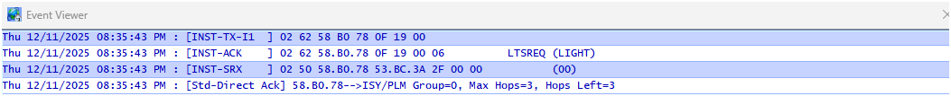

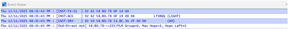

  5. I don't have an Eisy, but you should see some activity in the Event Viewer (Level 3) when it tries to read the PLM. The 1st line [GET-LNK-RSP] is a must. If it is not displayed, the Eisy isn't trying to read the PLM. If the process is functioning correctly, the Eisy will continue issuing [GET-NEXT-LNK-RSP] commands until it hits the end of the PLM table. Sat 09/26/2026 05:05:07 PM : [GET-LNK-RSP ] 02 69 06 Sat 09/26/2026 05:05:07 PM : [LNK-DATA ] 02 57 E2 00 58 B0 78 01 20 45 Sat 09/26/2026 05:05:08 PM : [GET-NEXT-LNK-RSP] 02 6A 06 Sat 09/26/2026 05:05:08 PM : [LNK-DATA ] 02 57 E2 10 58 B0 78 01 20 45
