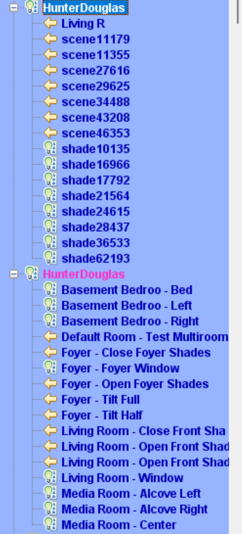

  23. @sjenkinsOK I see 17 nodes loading into PG3 same as in the production version but if I open the AC I see this The top one is from the beta version. The last entry there should be "Living Room - Open Shades Half Way". Looks like you are truncating the beginning of the string instead of the end of the string? Also, I cannot get programs to open properly with both plugin versions installed. It mostly loads but then locks up or is too busy to respond and I have to kill the task
