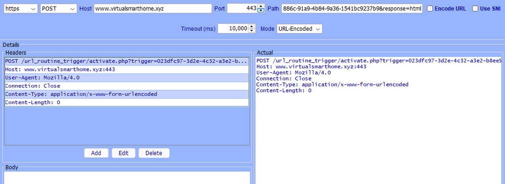

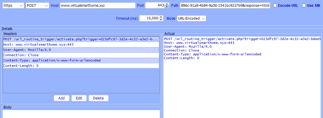

  4. Turns out, not VirtualSmartHome. I just had the same problem when I tried to code this into a plugin. The issue was the headers not whether it was HTTP/1.1 or HTTP/2. With the proper headers it works with either one. POST or GET also work.
  5. Thanks for your replies, I opened a ticket, and Michel quickly identified the problem: "It (the Virtual Server) does not accept http 1.1. It's expecting http2 which Network resources do not support." Thanks to Michel for the great support!
  6. Is there a character limit when creating the "Path" for a network resource? I have a 135 character "path" which adds ok. I can see the whole path but when I test it I get a 403 error. If I take the whole url and paste it into a browser it works fine. I have lots of network resources configured that work fine but nothing close to the length of this one. This is the url: https://www.virtualsmarthome.xyz/url_routine_trigger/activate.php?trigger=023dfc97-3d2e-4c32-a3e2-b8ee5c0e7ca9&token=af23886c-91a9-4b84-****-1541bc9237b9&response=html I have it set to https, POST, Port 443, Timeout 10000, Mode: URL-Encoded I've tried C Escaped but same result I've tried the 2 check boxes but no luck there either. Thanks for any advice. Update: I've confirmed that the entire url is being sent by eisy, using Wireshark, so that's not the issue.
