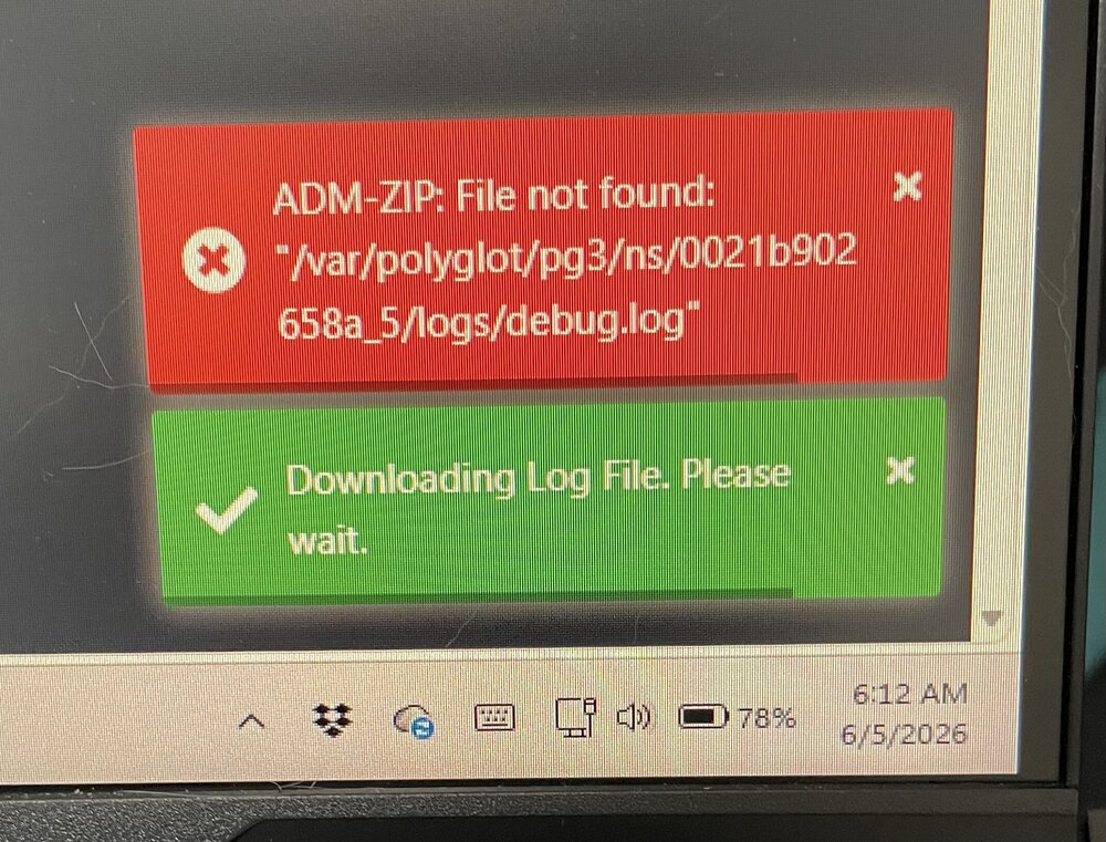

The VUE plugin on my eisy has started to fail every few days. I can't download the log, the system says it can't be found. Pressing restart solves the problem and once it's running the log file is available. The file however only contains log info starting with the restart.
The plug-in debug log files are only active for 24 hours. At midnight, the eisy backs up the current log and then clears the active log.
Likely whatever happens, happens before midnight so no data is being collected in the log from that point on. The previous daily log files are saved but the only way to access them is via the command line.
Chances are the plug-in fails to re-authenticate when the current token expires or the server stops responding and plug-in needs to re-open the connection to get it working again. The latest version, 1.0.27, was supposed to try and address the server not responding issue.
If authentication fails, the plug-in gives up. The assumption is that something is either wrong on their end or the credentials are wrong and retrying to authenticate won't fix either of those issues.
