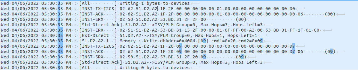

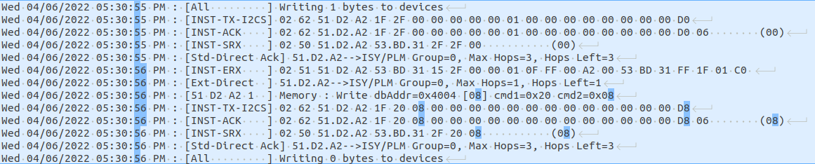

I took a look at the communications in the diagnostics dialog and it's pretty clear that to toggle this option a very minor amount of bit twiddling is required:
http://www.westhaver.com/isy_event_viewer_led_backlight_toggle1.png
http://www.westhaver.com/isy_event_viewer_led_backlight_toggle2.png
Is there any mechanism provided in ISY to generate custom communication transactions for situations where ISY does not provide an interface?
