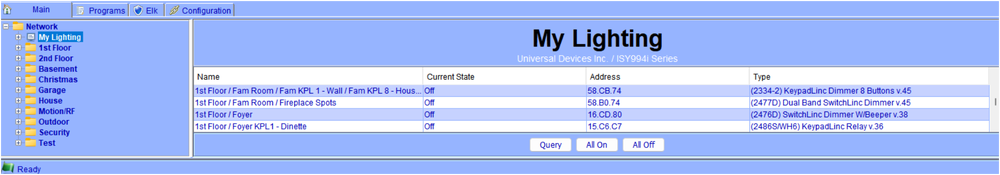

  1. To the best of my knowledge, Smartlabs HAS NOT removed the all-on command from current PLM's.  They are still capable of sending the command (it is a valid command).
  2. Smartlabs HAS removed the all-on command from some of the newer Insteon modules.
  3. To the best of my knowledge, the IOLinc is STILL SUSCEPTIBLE to the all-on command.
  4. The ISY can still send an all-on command if you wish to test your devices.  Navigate to the "My Lighting" item in the Admin Console Tree and you will see the all on at the bottom of the window.  This will execute the group all on command.  Devices that do not respond have been "fixed" or can't hear the communication.  Devices that do respond are susceptible.
  5. Most of the issues with all on events seem to involve motion sensors, keypads, or devices that trigger programs that talk beck to the same device.  I'm not aware of any specific Alexa issues (but then i don't use Alexa).
The wiki mitigation posted above works reasonably well.
There are Many posts on the forum.  Try searching "site:"forum.universal-devices.com" all-on event"
Best of luck.
